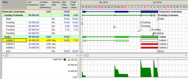

Start and Finish floats can be different not only for interrupted activities.
Agree, I just wanted to highlight materials leveling as another reason for start and finish float be different. If during activity execution materials are depleted before activity completion the activity will be stopped until more materials become available.
Financial constraints can be another reason for for start and finish float be different.
I recall some references(1) about different start and finish float values but I do not recall one that makes reference to activity splitting by consumable/materials or by financial resources leveling engine, perhaps because not all software is capable of such functionalities.

24 years 8 monthsHi Rafael,thank you for
Hi Rafael,
thank you for noticing that the field Interruptions was missed in the list of project columns.
Please download the latest version of Spider Project and find column Interruptions in the Other section.
Filtering by not empty values in this column you will see all activities with interrupted execution.
