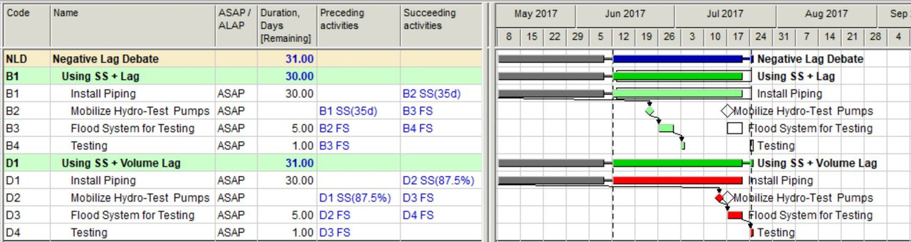

A required transition period might still be an issue, for any other scenario use volume of work lags unless the mere passage of time is the driving condition.
When updating the schedule time lags happen at a fixed rate no matter if predecessor works fastr or slower while volume lags are a function of predecessor progress. More often than not, lags are intended to be a function of predecessor progress.

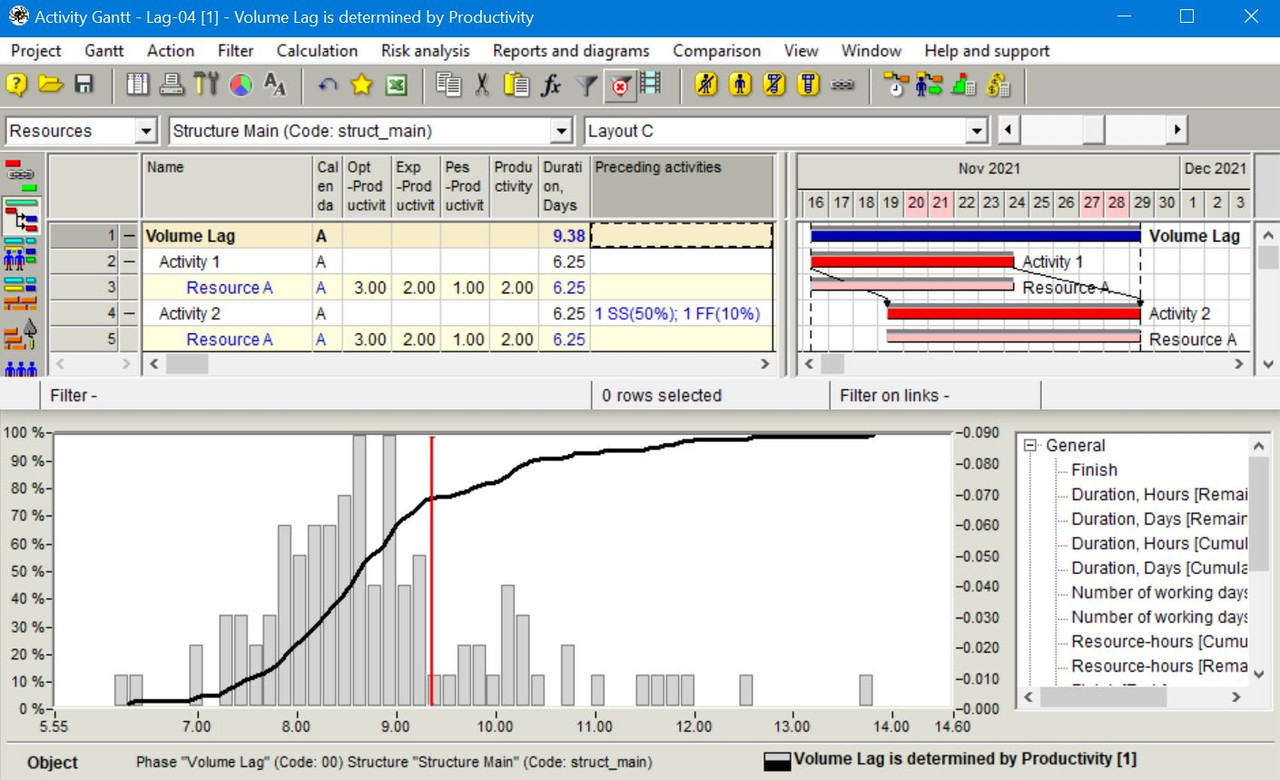

Imagine a three thousand activity network schedule with multiple relationships using time lags instead of volume lags.  Verifying and adjusting al remaining time lags upon every update can be daunting and error prone.
The same goes with Monte Carlo; job and activity non-deterministic durations as well as volume lags are calculated by non-deterministic production rates. If using duration type lag activities you might get thouthands of iterations that do not make sense. The key is on the source, the production rates.
