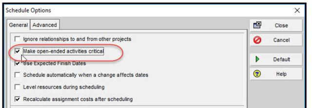

6 years 4 monthsHi Guys, I sthere any other
21 years 7 monthsI wonder if setting all open
I wonder if setting all open ends as critical will make the resource leveling algorithm to yield undesired results when resources are shared among the different paths.

16 years 3 monthsyou can make open end
you can make open end critical but techanically there sould only be 1 open end which is the last activty in the schedule
