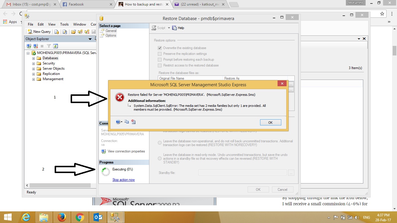

I were working in windows 7 and i changed it to windows 8.1, so i setup primavera 6 and when i tried to restore the backup file it failed.
can you explain how to restore database on microsoft SQL 2005.

what do you mean you changed your windows you udated the version of windows ?
also can you type the error message the screen shot is too small to read
