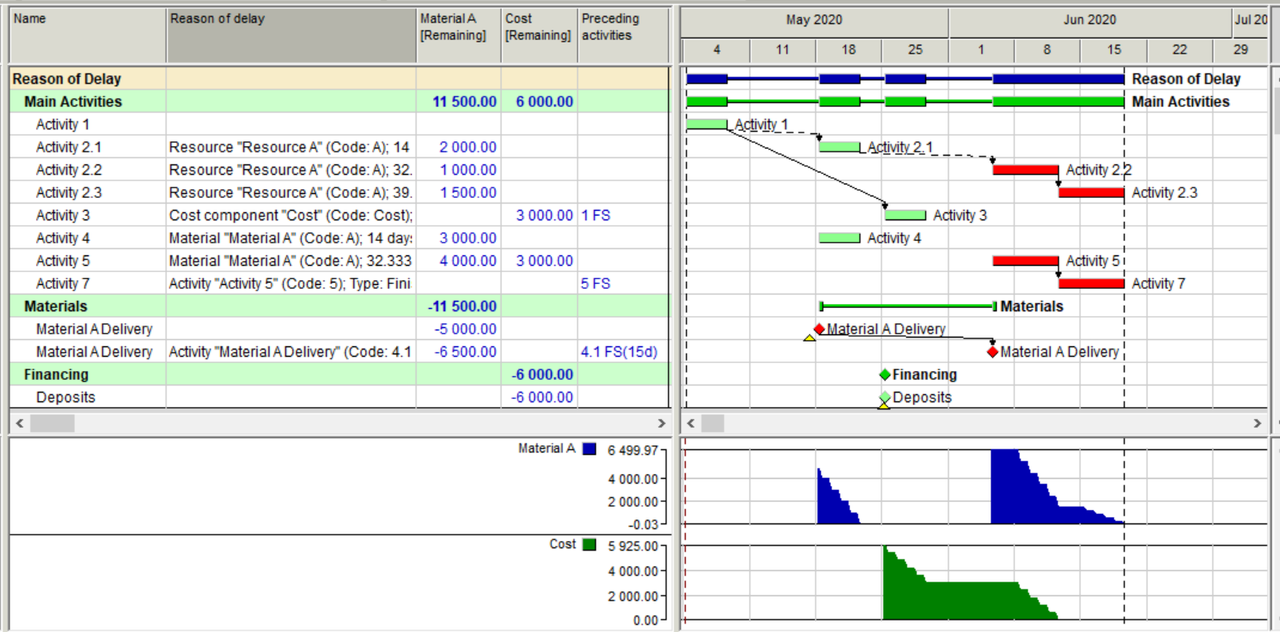

In complex schedules with hundreds of resources and activities:
Tracking link lines is not practical.
Using standard links only to see what is driving activities is not always enough, using resource links when the software can create them to see what is driving activities is not always enough as it will fail to identify the resource.
Tracking resource links will not make it when materials and financial constrains delay the activities.
A single column we call Reason of Delay will tell you what is driving the activities.

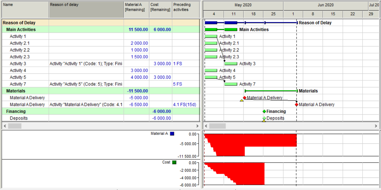

Simple scheduling without resource leveling.
After resource leveling.

21 years 7 monthsIn complex schedules with
