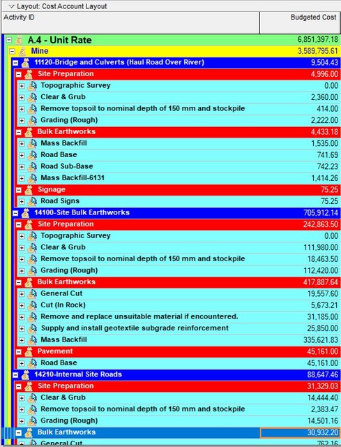

The SOV and CBS is defined under Cost Account and assigned into Resources of each activity. WBS is also define separately under WBS module. You can assign multiple resources into activity with different cost account and same thing with activity, you can assign Cost account into single resource assigned to multiple activity.
19 yearsThe SOV and CBS is defined
See below sample for your reference.
