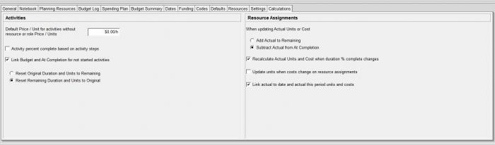

If you are using the excel import method for Auctal / Remaining & At Cmpletion it is important to get your project set up right in your EPS node: Under "Calculations">>"Resource Assignment" section. (Snapshot below).
I have run into a few problems in the past because I didnt have my initial set up right while using the import method.
[[wysiwyg_imageupload:5693:]]
