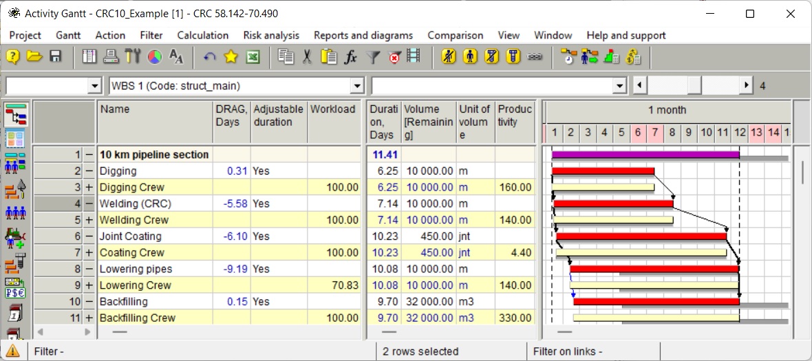

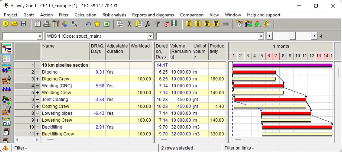

I don't know what is meant by Gantt split. In Spider project it is possible to set any number of dependencies between two activities connecting any points of these activities.
But it is not sufficient for takt planning application. I understood it as crew workloads leveling for synchronizing their productivity.
In many cases it provides better schedules but it is not always necessary.
Similar functionality in Spider Project is called schedule adjustment. When schedule adjustment is applied Spider can automatically increase activity duration (and adjust assigned resource workloads) if it leads to better schedule.
A simple example of the schedule before adjustment:
and after adjustment:
Schedule duration was optimized by increasing duration of some activity and adjusting assigned resources workload.
This is just simplified example, the number of activities with adjusted duration can be large. At time-location chart the picture is similar to those shown by takt planning sources. This is special case useful in some projects for some activities.

24 years 8 monthsHi David,I don't know what is
Hi David,
