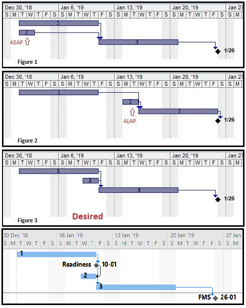

Hi there. Moderate Projects user over the years with a scheduling need I've never encountered and I'm hoping I'm just ignorant of an easy solution. I'm currently using a very old 2002 version.
Attached is an image with three figures (all different screen shots from a simple 'project' created just to illustrate my issue). This sample project has 3 floating activities and a 'project completion' milestone which has an artificial hard completion date. The behavior of Activity #2 is what I'm attempting to control (I want the float gone).
All relationships are simple 'FS' with zero lag. Activities 1 and 3 are constrained 'ASAP' in all three figures.
In figure 1, Activity 2 is constrained 'ASAP' with the expected float reflecting the difference in duration between activities 1 and 2.
In figure 2, Activity 2 is constrained 'ALAP' which has taken the float out of Activity 2, but pushed Activity 3 down to the project end and the float is now reflected in the start of Activity 3.
Figure 3 is what I'm trying to achieve (without a hard constraint). I want the float gone between activities 2 and 3, but I can't have 3 pushed down to the end of the project. In other words, I want Activity 2 to be ALAP while Activity 3 is ASAP. This may sound like a directly conflicting requirement (and it may be as related to Projects' capabilities), but it's not conflicting if one thinks of activity 3 being ALAP relative to Activity 3 while Activity 3 is ASAP relative to the project as a whole.
Can this be done in Projects 2002? Any version of Projects? Any version of a CPM software?
Remember, it's the described principle I'm interested in -- it would be easy in this little snippet to just 'hard constrain' and get away with it, but I'm involved in a relatively large scheduling project and in such any hard constraints will really create issues as things are updated.
Thanks.
JB
Alexandre Faulx-Briole 👤 Member for 23 years 5 months
Tom,
you are perfectly right, SF link is only a workaround; it does not answer the fundamental question of the difference between Total Float or Free Float being used in the so called ALAP constraint
I will have a try to your VBA macro
Alexandre

Tom Boyle 👤 Member for 19 years 7 months
Alexandre,
If your only objective is to manipulate the dates to get what you want, then the reverse logic and SF link may be OK; it seems common enough among MSP users of all experience levels.  It is nonetheless a misguided approach in logic driven planning, in my opinion.
Equipment must be delivered before it is installed - full stop.  To discard this requirement and insert the SF link as you suggest is to damage the proper logic flow through the schedule.  As a result, the late dates and Slack of activity 2 (delivery) and its predecessors (e.g. specification, PO, design, production, etc.) are incorrect.  Moreover, the correct scheduling (early dates) of activity 3 (installation) and its successors is not assured in case of a delay of the equipment.
Hello Planners,
I would use a Start to Finish link between the activities 3 (Predecessor) and 2 (Successor)
By doing so, the activity 2 would finish at the begining of activity 3, and would not push activity 3 ahead against the milesone
This is the best workaround in MSP, whatever the version you are using .
Alexandre

John Borton 👤 Member for 7 years 10 months
Abel:  // "Wouldn't it be possible, to simply run Activity 2 with a relation type FF to Activity 1? " //
Not and get the desired result - I dont' want Activity 2 to be scheduled to finish with Activity 1, I want its finish to be tied directly to the start of Activity 2 with no float ever.
Logic: (part of the confusion may be a typo in my OP -- fixed here)
1: The finish of Activity 2 as late as possible relative to the start of Activity 3
2:  The start of Activity 3 as early as possible relative to the finish of Activity 1
As Tom has accurately described it, it's a 'just in time' scheduling issue.
Tom's Macro has worked marvelously btw.
JB
Abel Santos Silva 👤 Member for 15 years 9 months
Hi John,
I'm glad you got it worked out.
Sorry I didn't think to mention that macro, which I don't use much.  Maybe I would use it more if it were improved by combining it with a longest-path-type backward logic tracer.  As it is, I've become less reliant on ZFF constraints over the years - in both MSP and OPV - so it's not worth the time to improve the macro.
Much appreciated Tom.  Your idea was a great workaround and in many instances worked great in my schedule.  I had a few places where there were predecessors to the Activity 2 you helped me with and those predecessors had the same issue but without the same solution available.
I finally found this blog entry where a user wrote a MP VBA macro that whips through, finds all the instances where you want the ZFF (zero free float) behavior and replicates it programatically (using the ugly 'C' word).  I modified it slightly to meet my needs and it really works great, so until I can afford Primavera, this will have to do
http://www.boyleprojectconsulting.com/TomsBlog/2016/08/31/simple-macro-…
Thanks again.
(LOL -- just realized that it was YOUR blog I just posted.  So DOUBLE thanks and best wishes during the upcoming hurricane headed your way - stay safe.)
Hi John,
The behavior you seek is that of a Zero-Free-Float constraint, which is not available in MSP.  When used in a forward-scheduled project, the ALAP constraint in MSP is in fact a Zero-Total-Float constraint, which serves no useful purpose as you have found.  Though my memory is a bit fuzzy on the earlier versions (and I skipped from Project '98 to Project 2003), I'm pretty sure MSP has never had a ZFF constraint.  The workaround, at least where Task 2 represents a just-in-time delivery, is to insert a readiness milestone between 1 and 3.  Then make that milestone an FF predecessor of 2.  This keeps the logic flow intact without using the C-word.
Zero-Free-Float constraints are certainly available in other scheduling software - P3 actually called it by that name.  P6 calls it ALAP, which of course causes much confusion for P6 user who stumbles into MSP.  I think Asta Power Project allows entire strings of activities to be similarly delayed within available free float - pretty flexible.
I'm not sure if PP has fixed its image retention problem (uploads like yours were only retained for a couple hours).  If not, I'll move the image below (including the workaround) to an external host. Good luck, tom
[[wysiwyg_imageupload:6094:height=618,width=494]](18Sep'18 - changed image link to external source.)
