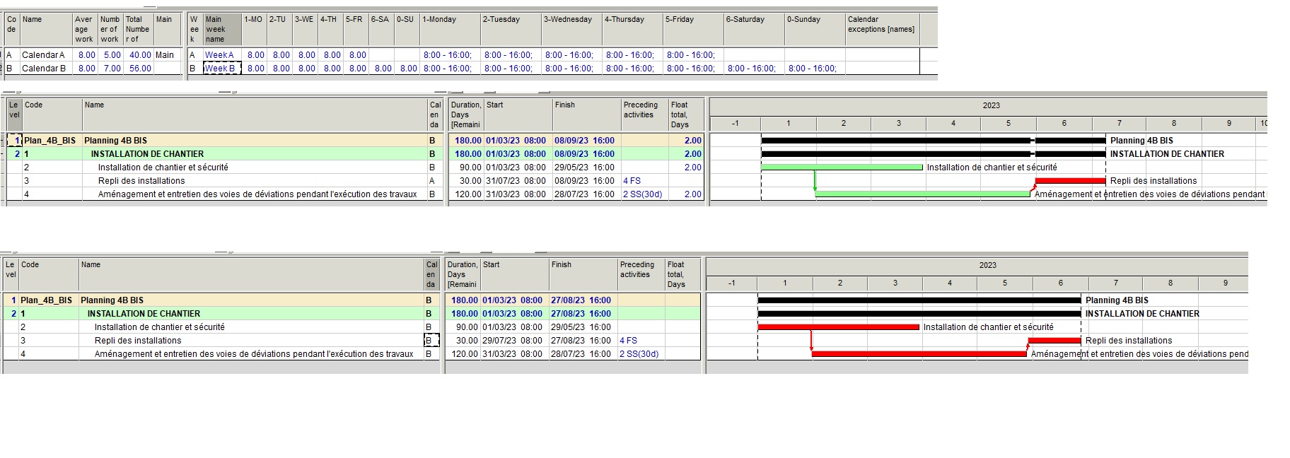

Hi friends,
Today I did a simple testing take into account 3 activities and different calendars A (5WD) and B (7WD) and I had two different answers but, my question is, considering the CPM schedule we are limited to found a correct critical path according the calendar? What exactly happened?

Daniel,
There is no commonly agreed definition of Critical path :) Different PM standards, books and Systems have different interpretations. When a schedule only has FS activities, one calendar, no constraints, no resources, there is no difference in calculation. When they are presented, you can see anomalies.
It is particularly true about a way Total Float is calculated.
Generally, there are two main methods:
- Activities with TF =0
- Longest path
You just find an example to demonstrate both methods. It is widely accepted that the Longest Path is a better way to control Critical activities.
Daniel,
This is not workaround.
Setting 2 days total float as the condition for selecting activities that are considered as critical you include in the critical path those activities which delays can delay project finish. In case when an activiy with 7WD calendar has 5WD successor and finishes on Friday evenig it has two days total float. But if 7WD activity finishes on Monday its total float is zero though succeeding activity has different calendar. With some delay of preceding activities it can get some float that is less of two days remaining on the same path, with another delay its float can remain zero.
Critical Path shows activities that require most attention because their delays can delay project completion. These activities belong to the Critical Path even though in some moments during project execution they can have positive floats.

Daniel,
you changed the calendar of the last activity in this schedule from 7d/w to 5 d/w.
In the initial schedule its start was planned on Saturday but as the result of changing activity work week it was moved on Monday.
Preceding activities have 7d/w calendars and as the result they got two days total float, Now the preceding activity can finish on Sunday without delaying succeeding activity.
You can define what activities will be considered as critical in the current project in the project properties.
In particular, you can set that an activity will be considered as critical if its total float is less than 16 work hours.
In this case your critical path will not change.
Vladimir
