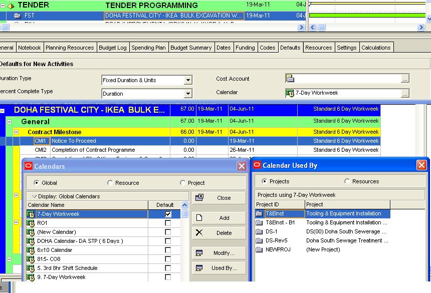

In Project Detail option  i Set Default Calender - >7 Days Work Week
& Enterprise Calender -> 7 Days Work Week
But Still The Summary Bar is Taking Activity Calender(Standard 6 Days Work Week)
In Calender Option-> Used By Also it is Not Showing Project Name
Is there Any Setting I need to Change in Project Detail

My Problem is Not Activity Calender
My Problem is with WBS Summary Bar Calender
Because P6 will Calculate Original Duration of WBS Summary Bar Based on Project Default Calender
My Project Default Calender & Enterprise Calender  is 7 Days Work week
So My WBS Level 1 Orginal Duration Should be 78 Days (19- March to 04-June) But its Showing 67 Days based on (6 day Work week Calender)
Can u say me How can i Show Orginal Duration as 78 Days
I am using P6.7 Oracle Database

Hi Mr.Mani,
as per my understanding i thik you have already assigned 6 days calender to activity and then you have change the default calender to 7 days work week, thats why it is still showing 6 days work week calender.
If this is the condition you can opy for global change or you can just select 6 days calender for one activity and the fill down to rest.
