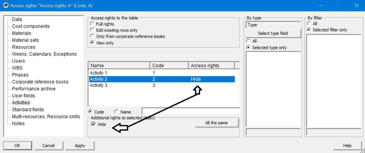

If using Spider I find it easier to use access control and hide whatever individual activity you want to prevent some user to see.
hide02
  • No value born from hidden activity will be shown; it will be hidden on predecessors and successors screens, references will be hidden in any view.  The use of filters  and activity codes can make it easy to select the activities to be hidden.
  • Access right will be transferred within the transfer file; the user after receiving the file will still not be able to see the hidden activities.
  • Of course there are other options such as creating WBS that do not include these activities within its structure. Still some references might show such as reference to hidden activities within links tables unless you also hide the activities within the access rights for the user.
