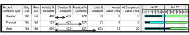

I use different software. Take a look at the following figure %Duration and %Effort are different.  If at gunpoint asked to select a single %Complete figure I would pick Intuitive %Duration for turnaround projects where main focus is on project duration.

Rolling-up Physical % Complete only makes sense for common parameters.
  • Oranges and apples do not mix, an orange is not the same as an apple.
  • An activity can include several work volume parameters. They can be summarized at the activity level as well as at the group bars under separate fields.
  • Note that at any given point the percentages for different parameters can be different, please take a look to Activity 5.
