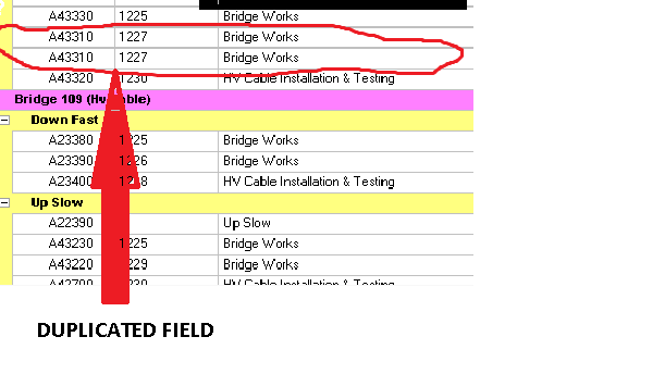

When copying and pasting an Activity with relationships I seem to be getting an SLDNA-0655-B error message. Obviosuly I've exited the program and restarted it, however the problem still seems to be there.
SCREEN SHOT BELOW.
1207
If any of you technical experts can offer any help, would be more than  appreciated.

is it possible that you have two projects open with the same activity numbers ?
look at the very top there should only be one project named with no comas after the project name

Hi Tom,
Fromwhat we understand, this is a documented bug on P6 v7.  You have to do is to download and install Primavera SP2 (service pack 2).  You will have to go to the Oracle support site and download the patch it is 130 MB.
