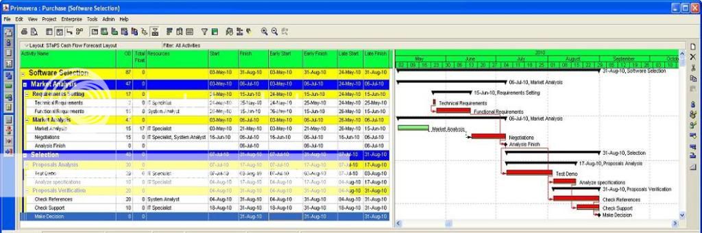

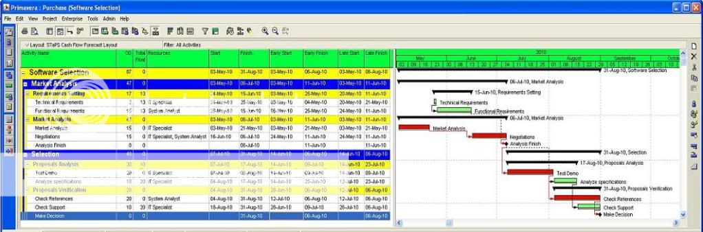

See belowcomparison:
Using Preserve schedule early and late date option:
Early and late date did not update and remain as original compare to start and finish date.
Purchase Fig 3
Proper levelling without using any option. Early and Late dates are updated as shown on Start & Finish dates.
Purchase Fig 4
Rodel

Thanks for the xer and correct me if I’m wrong. I downloaded the files that you shared and do the exercise. I suspect that the screenshot that you posted is level the resource using “Preserved scheduled early and late dates” options that its why it not showing the correct float. It forced primavera to retain early date which is the basis of calculating float. As shown below.
Purchase Fig 1
Note: I change the resource name to match on the screen shot that you used.
Here is the explanation using that option:
If you mark the Preserve Scheduled Early and Late Dates checkbox, the project’s current early dates are retained before levelling. In addition, when you preserve these dates, the module only forward-levels the schedule, which means that the early dates of activities from the start to the finish of the project are scheduled.
To review the levelled early dates, I show the Start and Finish dates to compare Early Start and Early Finish date as shown on the figure above.
If you clear the Preserve Scheduled Early and Late Dates checkbox, the module also performs backward levelling. Backward levelling schedules activities to occur as late as possible without delaying the project finish. The module reverses the levelling process, beginning at the project’s late finish and working towards the beginning of the project. If insufficient resources are available to schedule an activity on its late dates, the activity is advanced to an earlier date. When the schedule is levelled forward and backward (by clearing the checkbox to preserve scheduled early and late dates), the project’s early and late start/finish dates are updated as shown below.
Purchase Fig 2
On this exercise P6 clearly show that resource levelling facility is correct.

Rodel,
My example shows two computations of float for activity A1010, P6 says it is 10 days which does not makes any sense, if you delay the activity to late bar either over-allocation will happen or the job will be delayed, this breaks the basic rules of resource constraining. On the other hand Spider Project shows 2 days float, the correct value.
Does P6 displays a warning that for activity A1010 the displayed value of float will over-allocate the resource? I doubt it and would like to see such a report.

THE PROBLEM IS THAT FLOAT AS DISPLAYED BY P6 AFTER RESOURCE LEVELING IS PLAIN WRONG.
As long as float is mentioned in the specs the required software shall be one that shows the correct math.
Definition of float requires it to meet all logic and resource constraints. Showing incorrect float values for resource leveled jobs is wrong. If not available without delaying the job duration in compliance with resource requirements shall not be shown by pretending it is correct.

P6 actually warned that resource is overloaded. (see below) You’re correct that the cause of 13.33hr/d is due to duration change. The behaviour of P6 is depends on the settings. The user can control Primavera’s behaviour on settings available.
P6 Figure5
On this exercise Duration type is set to Fixed Duration & Unit meaning Unit/Time is variable but if the setting is Fixed Duration and Unit/Time or Fixed Unit/Time then the unit will automatically change and become variable.
Rodel

Anoon,
I just realized that the prior example sent to me is in disagreement because it was set up to work under optimization an automatic resource leveling option that consistently yields shorter job duration in Spider, I was comparing apples with oranges. The following is a screen capture of the resource leveling results using the previous sample job using Spider optimization.
RC1 Spider
I am using another example of the small project where all activities are linked only with Finish milestone. The float of activity 2 (ID:A1010) is rather strange. Please next after you will find the computations of float that Spider yields, these are the correct values.
RC2 P6
RC2 Spider
Sorry for any inconveniences, at times determining where some software will display wrong values for float is not easy for me when I do not have the software. The P6 files were issued on the run with the help of someone not in my office, this is making it harder to prove the point but does not invalidate it.

Anoon,
I did not worked the sample job but because I do not have P6. Note is using 2 resources, is not a single resource. Still simple enough for illustration purposes.
Activities
I agree with you a responsible software developer that knows some values as displayed are wrong should warn the user in a visible way, I would go as to say under these circumstances this knowledge should invalidate any disclaimer because is of his knowledge and hiding the fact is intentional. But jurisprudence is a dynamic thing; perhaps eventually under certain circumstances this protection will be unlocked.
