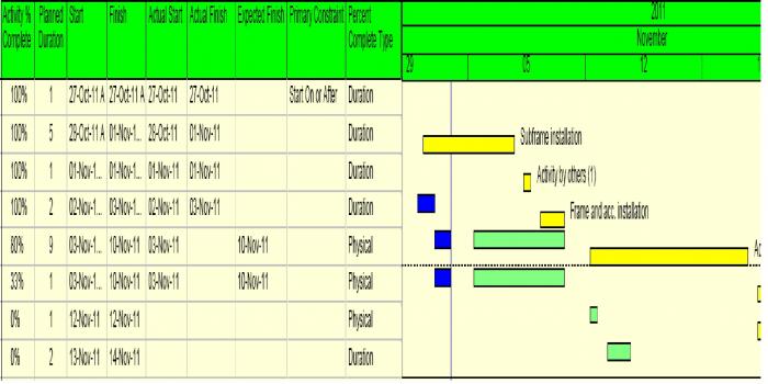

I'm encountering the follow problem:
after schedule the activities bars are splitted / divided.
I've used :
- Physycal % of calculation (insert the % value)
- I've used the  setting an expexted date and not
- not any resouces are loaded
- all links are FS =0
- there are not constrain
785
Pleas, somene can tell me why this happen,
thanks

I think it is because you are using Physical % complete. The % complete that you are entering is an estimate of where you think the work is and it is not related to the time left on the activity. I tend only to use physical % complete when a client requests that when a bar extends the % complete does not reduce, which happens when you are using units % complete

Hi Rafael,
I've tryed your suggestion but nothing change the gap between Actual work and remaining work still remain and it is positioned in the no working day.
But now I konw that it is not a mistake.
thanks
Ciao

Pierfrancesco,
Would you please display the link bars, the start of activities on lines 5 and 6 seems like occurring at the same time but the yellow bars, I assume the baseline bars, are displayed as if start of activity on line 6 depends on the finish of activity on line 5. If actual start of both happened on the same day then we have here an out of sequence progress. And if so, seems you are using progress override because I do not see the splits you mentioned just the non-working time necking.
Anyway it would not do any harm to find out about your selection of progress override or retained logic. I consider good practice to fix any out of sequence as well as to display necking. Necking can warn you of interruptions due to exceptions like vacations for a given resource that is delaying the activity. Even when it seems retained logic matches real logic at times some links are overlooked in the review, especially if resource dependencies, the best way to make sure all dependencies are taken care is by correcting logic and erasing the flag for out of sequence logic.
Photobucket
One possible solution might be to split the activity as follows, but it can be 4 days and 1 day or just 0 day remaining for 6a and 5 for 6b [the retained logic solution shown above]. The software will not do magic, will be limited to simple assumptions, assumptions not always true.
Photobucket

Pierfrancesco,
To clarify why this is happening, it seems the little gaps you speak of are occuring at weekends?
Ronald's answer should fix the problem, but to clarify why it is happening: because the actual work was completed before the weekend, and the remaining work is scheduled to start after the weekend.

Pierfrancesco,
Go to View / Bars.  Find the Remaining Work line.  Click on the Bar Settings tab.  Put a checkmark on the two Bar Necking Settings.  That should make you happy.  Good luck!

Try changing from retained logic to progress override and no longer you will see the split bars if this is the cause, but keep in mind this is not a true solution, perhaps 99% +1% of the time worst than retained logic option.
There are so many ways to solve each out of sequence logic that the only sure way is to manually fix logic that created the out of sequence occurrence. It is not only about relationships or about manually splitting the activity but also about the need at times to change activity duration in combination with the links and their lags.

I've already try it, but nothing happen.
I've tryed to change the data date from a day off to the next working day and this looks the solution, but I've still a little gap between the "bleu" bar (Actual work) and the "green"  bar (Remaining work).
User offline. Last seen 7 weeks 6 days ago. Offline
Look for out of sequence progress it can happen with FS relantionshps as well as with any other type of relationship.
