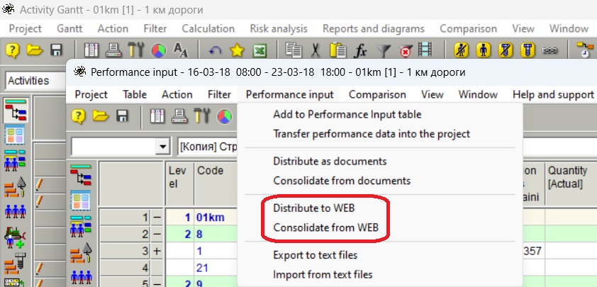

Thank you for the explanations, I found useful information on http://www.spiderproject.com/ru/index.php/spabout/groupwork

You responded: "These documents (actual data entry forms) can be opened by Spider Viewer if responsible person has an access to the corporate network, or they can be placed into Web and opened using tablets or phones.". I did not see an option to upload documents (generated by Spider from Actual Data Input Table/Performance Input/Distribute as documents) to WEB. Can this be done natively or does it involve a more complex procedure as saving the documents as html, then placing them on the web, entering data, converting them back to spider documents and the bringing these documents back to the actual data input table via Performance Input/Consolidate from documents. If either of my assumptions are wrong please go into further detail on how therese documents can be ditributed/consolidated via web interface.

Manager of such subproject gets its schedule updated in the original project. His subproject also have Resposibility structure that shows who is responsible for what. So he sends documents that specified the work that must be done during next day to all resposible persons. These documents (actual data entry forms) can be opened by Spider Viewer if responsible person has an access to the corporate network, or they can be placed into Web and opened using tablets or phones.
