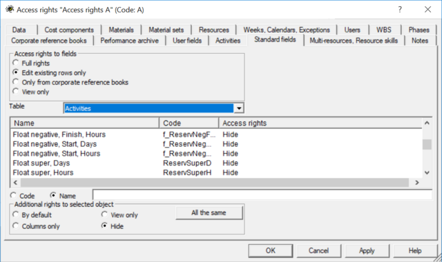

If you need to take control on what data can be viewed by the recipient, as it happens frequently, then a static view might be your only option if your software and viewer cannot take control of access right when transferring files.
  • The transfer file must contain the access rights to keep control on what data can be viewed by the recipient.
  • This should be easy to implement, similar to accessing a file within a network.
  • It is not just about what costs, if any, the recipient will be allowed to see but everything else.
  • It is not unusual to hide Total Float [TF] to subcontractors and suppliers as well as to give them access to a limited set of activities. I would not show Free Float [FF] to a supplier while might show FF to a subcontractor as to provide him with some information on how to distribute his workforce without delaying the start of any activity.
  • Scheduling for Subcontractors  Page 7: Owners & GC worry about Total Float while Subcontractors really only consider Free Float. Many GCs do not even share what the project total float is for the Subcontractor. Subcontractors should look at their last activities in each chain of work, note the Free Float value, and then disperse that float throughout their chain of work.
  • I cannot see much value on a reader/viewer that overrides access rights.
  • Access-Rights

It depends on the software that is used.
In Spider Project it is possible to create responsibility structure and automatically send specific portions of the project and tasks planned to be done in specific periods to those who are responsible for them.
Reports are also automatically collected in accordance with responsibility structure.
