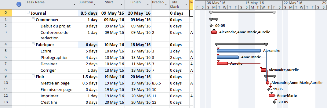

Has somebody noticed that Microsoft dramatically changed the way resource leveling is computed since MS Project 2013?
Figure 1 shows a project sample leveled in MS Project 2010: task 8 has moved after task 5 as Resource 1 was overloaded

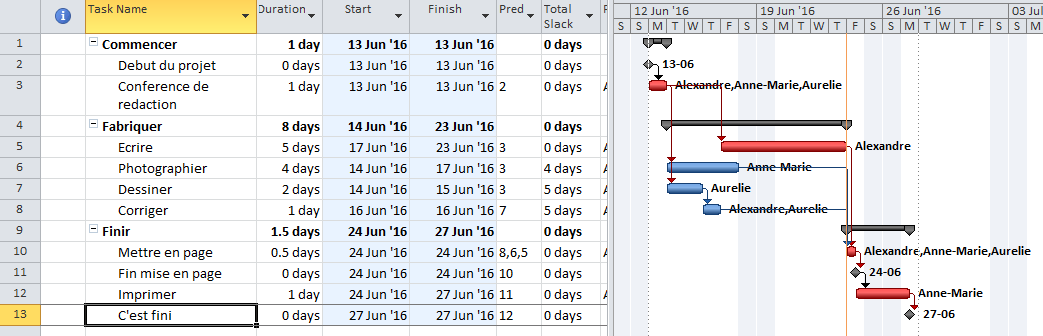

Figure 2 shows the same project leveled in MS Project 2013: task 5 is moved after task 8
Both projects have been leveled with all the leveling options de-activated; resources 1 and 1 have a 100% max. capacity in the resource sheet.

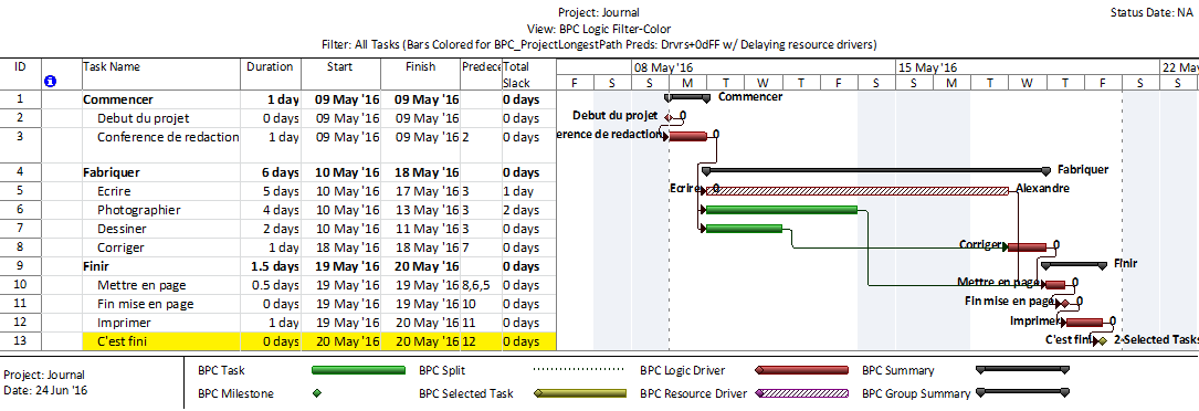

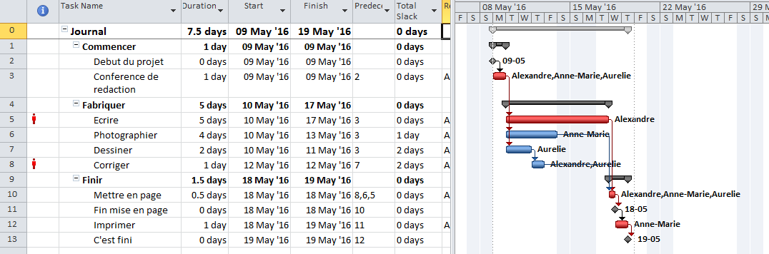

·         As a consequence of leveling, task 5 (the “critical” one) is scheduled first, while task 8 is delayed, and the project is extended 1 day.  Total slack is re-computed after incorporating the leveling delays, and a new “Critical Path” is displayed.
o   Perversely, Task 5 – which was clearly “critical” before leveling and is also clearly a resource driver for the project completion – now has 1 day of Total Slack.
o   Task 7 is shown as “Critical,” even though there is neither a logical nor a resource-driving reason justifying it.
o   So in short, the MSP 2010 leveling algorithm can substantially change the “Critical Path,” and the resulting slack values can be completely misleading.  (I wrote about this here: http://wp.me/p6CCB4-v.)
o   This figure illustrates the actual resource-constrained Longest Path through the 2010 schedule (from BPC Logic Filter).

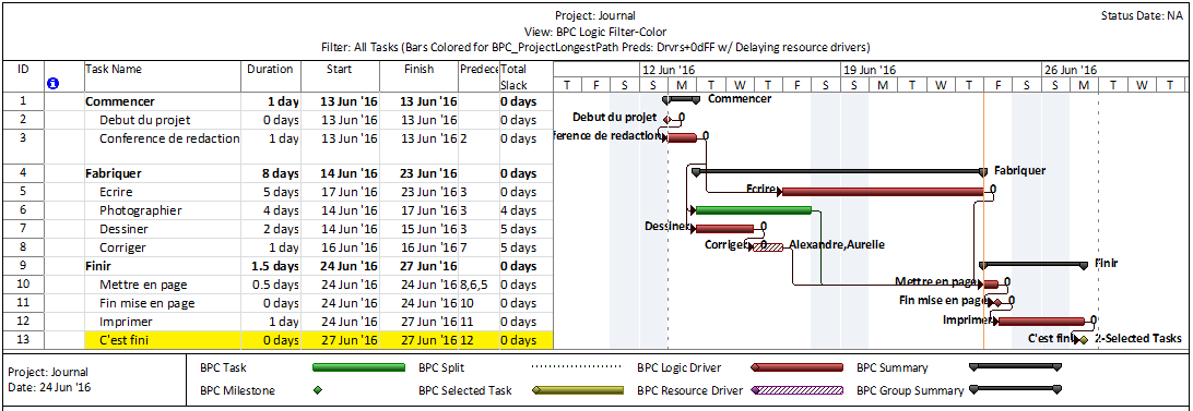

·         In contrast, MSP 2013 task gives greater scheduling priority to task 8, delaying task 5.  I suspect this is driven by some tuning of the leveling rules around Total Slack. (I’ve mimicked this in my MSP 2010 model by explicitly prioritizing task 8.)
o   The resulting “Critical Path” appears essentially the same as the pre-leveling version, but with an added 3-day leveling delay before task 5.  This may give project managers confidence that the leveling exercise has not “screwed up” their critical path.
o   Unfortunately, the project finish has been extended by an additional 2 days compared to the MSP 2010 leveler.
o   The project manager’s confidence in the critical path is still misplaced.  Task 7 and task 8 are now shown as far from critical, with 5 days of total slack.  As shown in the next figure, however, they are obviously on the resource-constrained longest path through the schedule.
