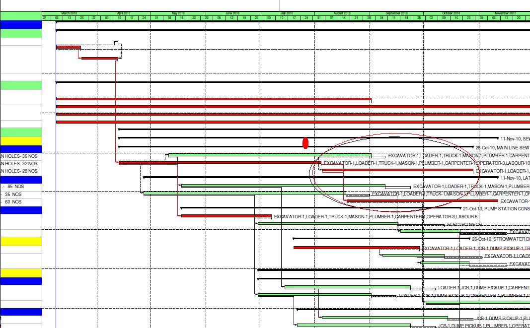

Please help me to show the Resourse bars with Resourse name and numbers as label...
Here by I attached a picture...
In bars I want to show the resourses and number of resourses also.....

Post the whole snapshot. I tried all the options. It must have been done in several steps, I guess.

But How to show the numbers ?????in the pics Its showing resourses and the numbers per day also....

1) Right click on the on the bar area and click "Bar Settings"
2) Go to "Bar Labels"
3) Select which bars you want to be labeled, then "Add" ---> "Resources"
