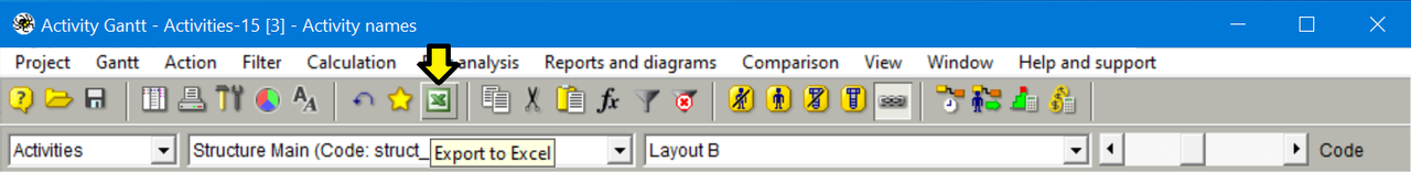

If clicking the Excel icon is a workaround then what is not?  So easy it does not make sense for the software developer to add such visibility under small dialog boxes.
Image-057
Unique activity ID is the ultimate activity identification used by the software.  Creating the Excel worsheet can be done at a single click of the mouse unless you are using outdated software.  Frequently the software locks the windows and does not allow you to see other windows from the same software instance.  The software I use allows me to run multiple instances of the same schedule but for such simple task it is better if using Excel.  Even better if using two monitors and keeping the Excel worksheet, the specifications, the drawings, the estimate, a PDF of current schedule Gantt ... on the second one.
Looking by name one by one in large schedules with thousands of activities is not a good idea.  My examples are short.  It is easier to look in the Excel worksheet using filters for one or many parameters and copy-phase the ID.

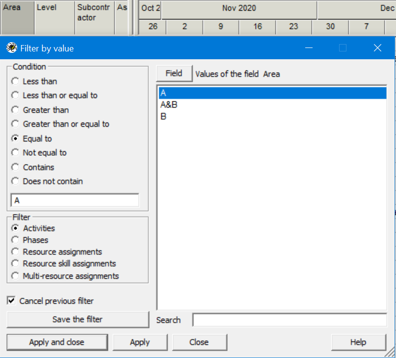

User offline. Last seen 7 weeks 6 days ago. Offline
Because many dialg boxes can only display a limited amount of activity fields I suggest exporting to excel the table containing the activity ID, Name, all activity codes and a few others such as assigned resources.  In this way at a click of the mouse you will have them all available for your view and to copy-paste target activity ID, easy to update after adding activities.

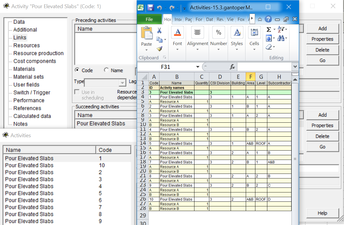

Image-057
For showcasing the idea in the following example I am naming all similar activities the same with no reference to the area in their names.  In this example I am adding activity links to Activity "Pour Elevated Slabs" (Code 1).  By looking at the Excel worksheet you get all missing information and more, even their assigned resources and quantity for all activities.  Copy-Paste long activity ID, Searching and filtering using Excel is easier than using a paper printout.

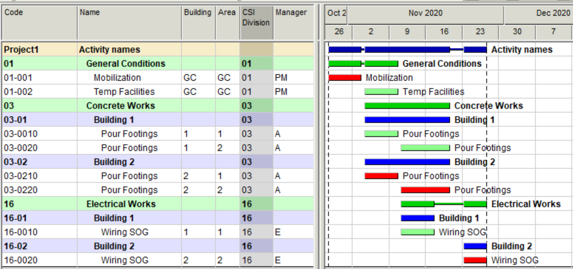

  • We combine activity ID, Name & activity codes.
Within activity ID we can easily consolidate 4 activity codes (Site, Building, Area and CSI Master-format codes) plus ID is in itself an activity code.  Say S for Site, B for building, A for area, GC for General Conditions ... Then for the last four digits we can use the first two to identify CSI Masterformat Division.
Activity ID                 Name
S01B05A03-0300       Pour Machine foundation
GC-0023                   Temporary Facilities

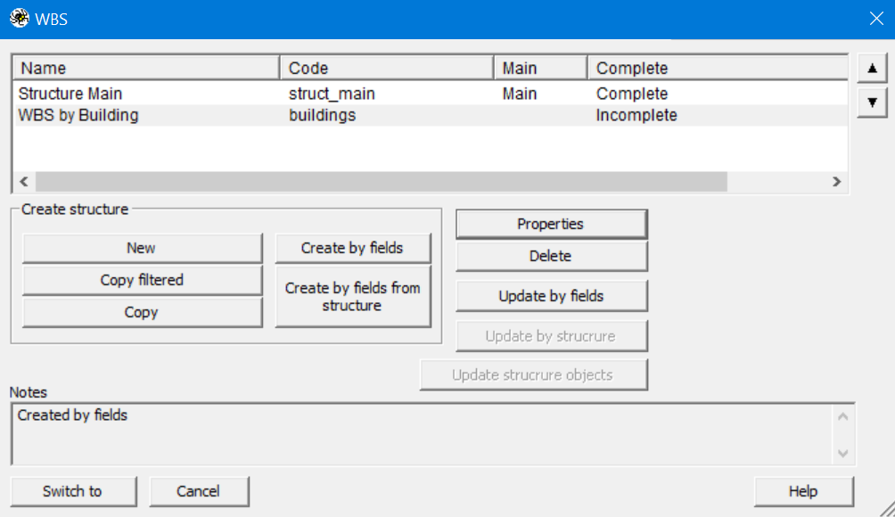

My choice is usually to keep activity name and ID simple and use activity codes.
Image-044
Say you have to add another building similar to Building 1, organizing by activity codes will help copy a similar building and with minor adjustments it is done.  No need to edit cumbersome activity names.  If using multiple WBS structures it would be easier.
