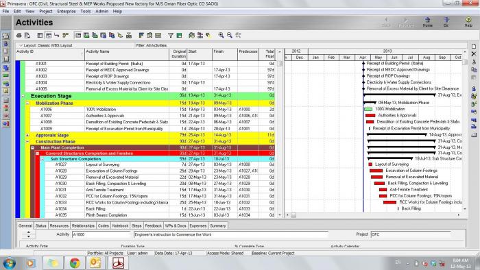

Hello Everybody,
I am facing the problem in my Schedule as the WBS duration is not matching with the dates. Duration is showing less than the original duration.
I have already checked my Calenders and there is no problem in that.
The issue is, the activities under WBS Main Plant, Covered Structure & Finishes and Sub Structure Completion is showing correct dates and duration as well. But the WBS duration is showing wrong whereas the dates are corrrect.
So. Kindly help in this regard how to make it rectify.

Ashik,
1)
Go to Enterprise menu > calendars
Scroll down until you find the calendar which has a tick in the "default" column
Is this the same calendar used on ALL activities within the Main Plant, Covered Structure & Finishes and Sub Structure Completion WBS?
2)
Got to Edit menu > User preferences
Set the unit of time for durations to "hour"
Is the duration of your WBS still incorrect?

Mr.Gary,
Thanks for your reply.
If you see in my above posted schedule, the dates are showing same as the sub activities but the duration is not correct.
I have checked the calenders also, even it shows 7 days/week as working days.
Your posted presentation is very useful but i didnt get solution for this question.
I have seen the WBS used by in Calenders also, It shows properly.
Kindly revert back to me
Ashik
