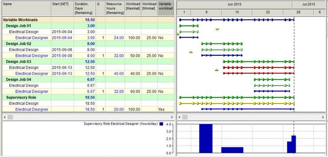

Easy in Spider Project, I cannot imagine scheduling design jobs without partial workloads and variable quantities and workloads.
I am curious about how others do it.
Variable-Workloads-Supervisory-Role-2
In Spider Project we call this variable resource assignment and it is easy to model.
I don't know similar feature in P6 and suggest to use following workaround.
Create artificial resource AdminCost that will be assigned at the hammock (LOE) activity that lasts from the project start to the project finish and set its hourly rate as the rate of your Admin.
Assign Admin to activities that require his personal efforts. Resource Admin hourly rate = 0.
This way you will get necessary information - right cost of your project, Admin project work hours and Admin "admin" hours as the difference between AdminCost and Admin work hours.
