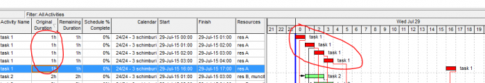

I have this situation:
Duration activities are  1 hour in level activities to share (corect) resources
2530
Duration activities are  30 min ; in level activities to share resources ; incorect results.
2531
P6 dont level activities with small duration (minutes) ?

If the above does not works then I suggest trying with the following simple schedule from scratch and see what happens. One resource A and one resource B units are available. There are no activity links, very simple. Even if one second activities it should do it.
