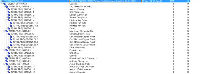

I am facing a weird problem with WBS on a specific programme. When I am grouping the activities by WBS under the Group & Sort option its not getting grouped so. Plus, under the WBS view its noy showing any dates and activities against each WBS. Actually, there are many activities under each WBS and there are various level of those WBSs as well. Please help!
Thanks!
Normal programme's WBS view
3659
The problematic programme's WBS view
3658

if you have an older version of the schedule you can export the activity and wbs assignment to excel. Then change the first part of the wbs to match the project id in excel save it then import it into your schedule where the assignments are missing.

Thanks for the reply. Activities were created under WBS only. But what went wrong I don't know. I still haven't figured it out yet. As of now, it looks like that I will have to assign the WBS to all these activities one by one.
Thanks again for the reply.

Try to summarize the project again but from what I see it looks like activities have not been assigned to a wbs
go to tools then summarize
