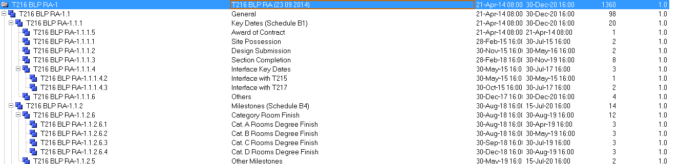

I am facing a weird problem with WBS on a specific programme. When I am grouping the activities by WBS under the Group & Sort option its not getting grouped so. Plus, under the WBS view its noy showing any dates and activities against each WBS. Actually, there are many activities under each WBS and there are various level of those WBSs as well. Please help!
Thanks!
Normal programme's WBS view
3659
The problematic programme's WBS view
3658
User offline. Last seen 2 days 14 hours ago. Offline
Try to summarize the project again but from what I see it looks like activities have not been assigned to a wbs
go to tools then summarize
