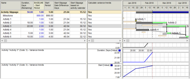

For a single activity diagrams, templates and table reports works as expected.  I take no issue on the diagrams when dates are mixed with other values, just create separate diagrams for a better view.
Date-Trends-Template
I am having issues when multiple activities are selected and with general reports. First version values are still missing; perhaps timescale could be expanded before project start to make some room for the display [something is shown]. I understand this is ongoing improvement.

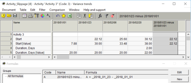

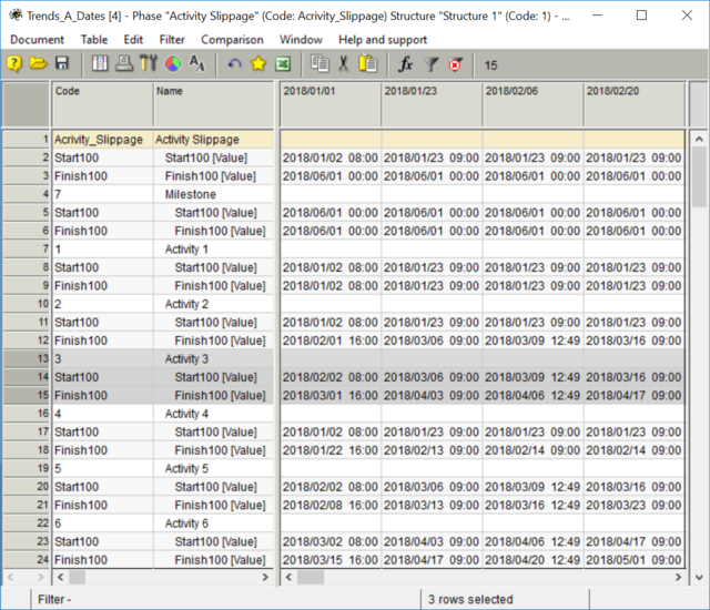

Figured it out how to make the transfer, easy.
  • Create UDF Start100 and Finish100; Set as Date Format, Copy-Paste Date Values, Change to Numeric Format
  • Execute Variance Report for UDF Start100[value] and Finish100[value], Change Columns format to Date
  • Transfer to Excel and make your diagrams as well as other calculations such as Start/Finish[date variance] as a date difference in addition to Start/Finish[workdays variance].

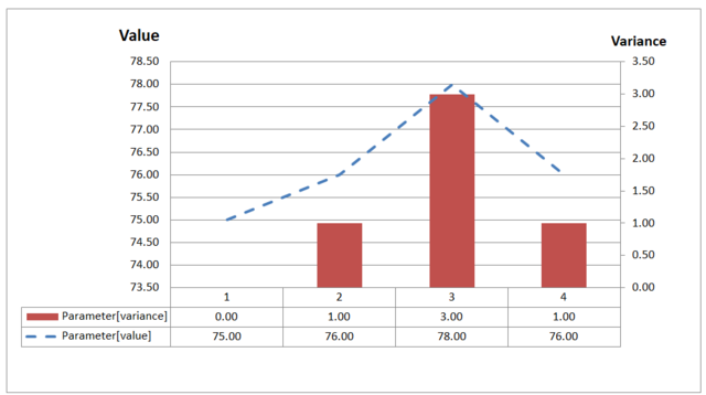

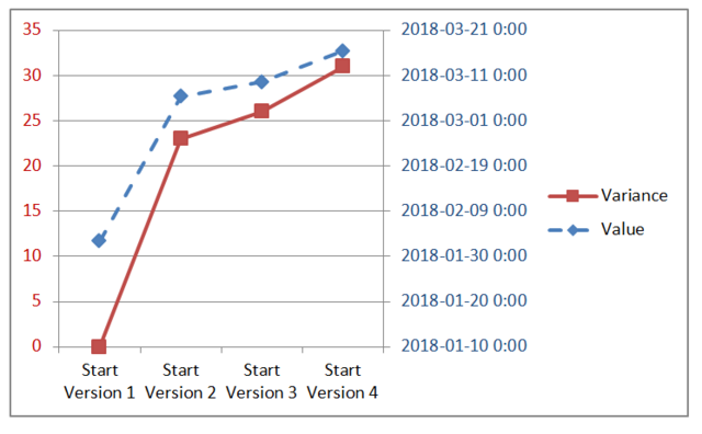

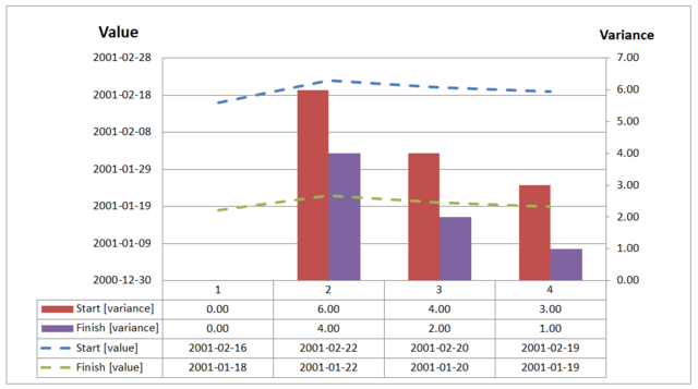

When we use two vertical scales in Excel we frequently use different Chart Types, usually lines & columns.  Values and variance look better if using different scales.  Maybe General Trend Parameters could be split to Numeric Parameters & Date Parameters, then variance shown as columns and values as lines similar to following figure.  An option can be to allow Date Parameters only on UDF selection, by means of simple formula any Date Parameter might be available.
  • For Date Parameters (Start&Finish) value scale will show dates and variance will be numeric.
Data-Types26

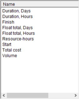

  • For Numeric Parameters (Duration, Float, Resource-hours, Total Cost & Volume) value scale as well as variance scale will be numeric but scaled different.
Data-Types27

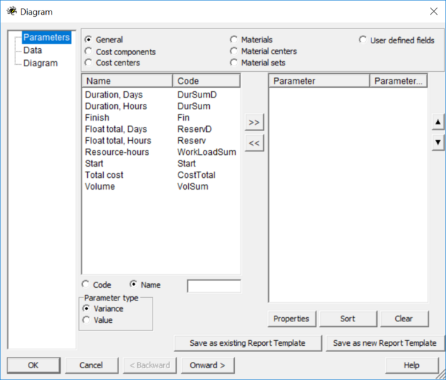

  • Maybe User Defined Fields should be split into Numeric UDF & Date UDF similar to General Trend Parameters, all UDF available on both.  Selection will determine data type of value axis. Values of the other type will be ignored and shown empty warning the user there is a mismatch, a warning might be issued after every re-create if this happens for user decide and fix.  To show current version parameter type on Diagram selection box should help.
Variance-Trend-Parameters

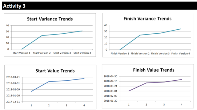

  • Another option, I can figure my combination charts if using Excel, but I need meaningful dates.  If you give me a function to convert the start/finish values to dates within the tabular report I will have dates in my tables as well as in my Excel charts.
Uper left looks satisfactory but requires to show table together with the diagram.
This may be done.

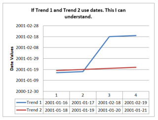

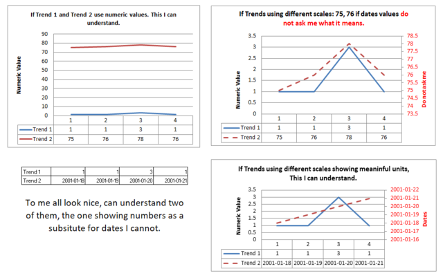

The following I can also understand.
Data-Types24
Let's suppose that one trend is 0 - 1 -3 -1 and another one 75 -76-78 -76.
It will not look nice with numbers and even less attractive with dates.
User offline. Last seen 22 weeks 3 days ago. Offline

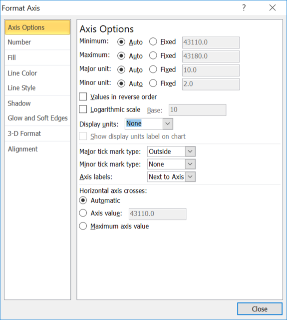

• The key is that for some lines, say solid lines, the scale are numeric values, for other lines, say dashed lines, the scales are Dates. Each vertical scale adjusted independently.
These shown values for date scale as well as for numeric scale need not to be aligned with every point. In most cases 4 to 6 values will be showm.
Dates that are shown with a number I am still wondering what they are I will never use. When mixed with numeric values it gets even worse. Date-Variance-Trends03
On the background Excel use numbers to adjust Date Scale. Excel displays the Dates not the numbers.  Auto adjust did not adjusted Dates to their minimum preventing the lines to be on top of each other.  It is all about how to display date values, what values or numbers are used on the background do not matter to the average end user.
Format-Axis
Numbers show delays in days and delays of start and finish may be easily shown in the same diagram. Dates of start and finish may be very different, trends will start at different points and inserting readable dates is a problem. I think that values report shall be left in the table In any case the table may be exported to Excel for creating other presentations.

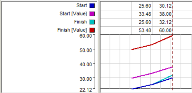

After many updates if selected versions are not shown it can be difficult to figure it out.
Trend-Versions-Missing

- "We will need to forbid showing more than one trend in the same diagram."
  • May I say, we will need to forbid to show incompatible scales on same diagram and allow to show more than one trend as long as the scales (time vs. numeric) are compatible.
  • Another option can be to show to the left numeric scale and to the left of numeric scale a date scale. Similar to Excel but primary and secondary scales to the left.
Lines might be shown solid for numeric type and dashed for date type, or vice versa; this can be shown in the report legend so everything is crystal clear.
  • Maybe the report date format could be set to be inherited from the format chosen for their respective columns, to make it a better fit for the report purpose, a better fit for the scale of the job.
  • Agree this problem do/should not happen in table reports.
I am exploring what happens if a trend user defined field is set to numeric in one version and changed in another version to a a text type an issue not existing on standard fields.
  • I expect text values to never be pulled down on any trend report, I expect only values of the type (numeric/date) of first version fields will be pulled for user defined fields.
Yes, I understand. Look at the table report.
We think about doing this in the diagrams because there is a problem when you will want to show several trends together (like time and cost trends or even trends of start and finish).
Variances are values that can be shown but dates and numbers require different scales. Start and Finish may have large difference and showing dates on the same scale may become tricky.
We will need to forbid to show more than one trend in the same diagram.

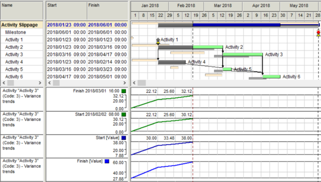

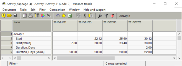

This is what I got.

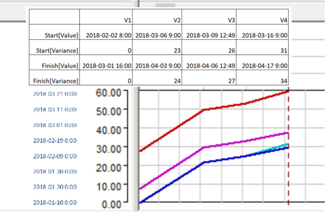

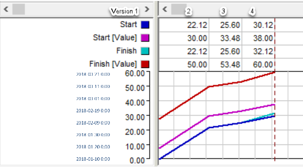

Start-Finish-Trends01
  • Re Variance: While I cannot see the versions I can understand the variance. There is no way to know if a version is missing as the user can select any subset. I can see a date I guess is the first value, because calendars complicate things I cannot guess the remaining dates.
  • Re values: I cannot see the versions I cannot understand the values. I see a lot of numbers but no dates.

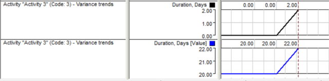

This is what I would understand.
StartFinishTrends02
  • I can understand the variance, I can understand the date values, I can see selected versions aligned with the variance & values.
try values trends for starts and finishes in the new version.

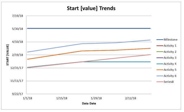

I am having issues to understand Start [Value], can you please help, maybe they are just temporary values, but if so why show them?
Variance-Values
Why not show the dates?
Start-Value-Trend03

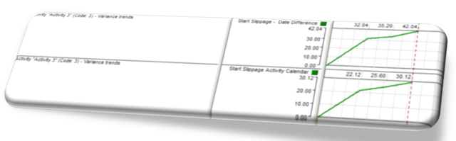

Great, I will always be able to create a UDF for hours for few schedules when need be, no big deal, but the Days/unit reminder can be handy for the diagram labels.
I can also use date formulas to calculate difference using dates instead of activity work time.
we expected that when people look for trends of Start/Finish they are interested in dates and so show days as the only unit.
When people plan and analyze durations that may be interested in work days and hous.
Yes, adding days as measurement unit for Start and Finish trends is useful.
