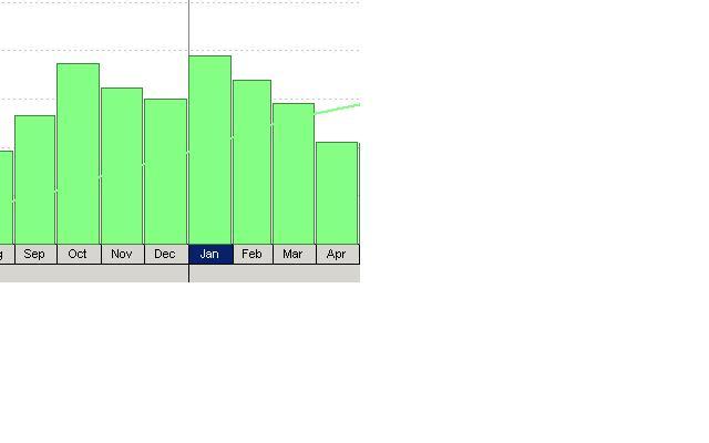

Have assigned 1 role to not started/in progress construction activity for histogramme show monthly men requirement.
1439
Have now been asked to show same on 1 histogramme but  split per operational area (S, N, W, E) which is a project code e.g  stacked histogramme to show that in January 2013, 2 men required in N, 1 in S, 2 in W and 5 in E.
Not been able to do so, only way I can think is to group projects on operational area and issue 1 histogramme for each of them.
Any ideas?
Thanks.
E.

Here’s my idea:
Create a separate resource for each operational area (ie. N,S,E,W).
Assign these 4 different resources to your single role using >enterprise >roles >resources tab >assign.
Filter each operational area one at a time (you may need to assign an activity code to split each area), select all activities in the individual operational area, then assign resources to roles using >right click >assign >resources by role
Repeat for N,S,E,W
Create a stacked histogram for these 4 resources rather than for the role.
