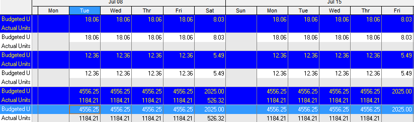

Have problem putting in actual in Resource Assignments tab on the left, please help.
6 replies [Last post]
charles charles
User offline. Last seen 13 years 11 weeks ago. Offline
Joined: 11 Jul 2012
Posts: 12
Hi everyone
I was wondering whether I can put in actual in Resource Assignments tab on the left, and i don't want it to split evenly.
For example
Monday 7 Hours
Tuesday 10 hours
Wednesday 3 Hours
The actual units in the table just grey out not allowing me to key in anything...:( please help... is there another way of put in actual day to day figure??? please help...

,, so my understanding is:
First, I define a financial period then i should be able to enter some actual figures?? then i store it?
am i right?? where i can put in the actual,,,

I am sorry..i am really new to p6.
After i store it, then nothing happened... what should i do to be able to update the day to day actual with this function?????

Charles,
Go to Tools... Store Period Performance....

Hi Raymund
I went to Admin -> Financial Period -> create the Financial period
however, where could i find distribution interval? Could you help explaining it more,, please,,

Charles,
Create a Finacial Period reference to your distribution interval.
Key in your actual units per finacial period.
