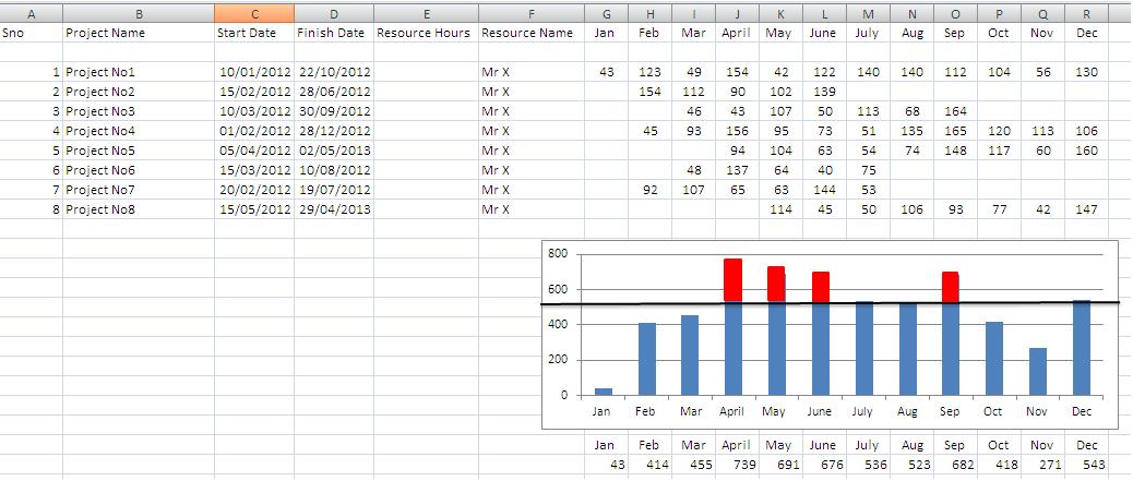

Can we do layout in Primavera where we show spreadsheet view on top and underneath we show resource histogram
I try to create this in excel to give you clear pitcure of my question

I am not a P6 user but occurs to me maybe at the Bucket Planning View you can see the resource usage at the top and the histogram at the bottom.
Unless bucket planning respect rules of logic as implemented on your software it shall not be used for resource assignments per se.
In any case by creating a report template at a single click of the mouse you shall be able to get the table, at another click you shall be able to export it to Excel and there with another few clicks you will get your histogram.
click, click, click ...

Thanks Sam did you try to print this out its not printing it just shows spreadsheet when i do the print preview

850
Hey John,
Try going to the "Tracking" area in P6.
You can manipulate the top area to Gantt, Spreadsheet or Resource Profile, and the bottom area should show the histogram.
You can select one or multiple projects in the left hand "Project" Display.
Hope that helps.
