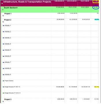

I have a query on the above subject. Please refer to the below snapshot.
835
Can anyone kindly explain me the formula for the P6 generated cost %tages as below.
1) %tage outlined with yellow rectangular box
2) %tage outlined with blue oval
3) %tage highlighted with cyan colour.
Thanks a lot in advance.
I really appreciate your answer.

Cost % of Budget (%)
Cost % of Budget threshold value is expressed as a percentage. An issue is generated if the ratio of the activity's actual cost to its budgeted cost (actual cost / budgeted cost * 100) falls beyond the threshold values.
Actual cost is the same as Total Actual Cost, and original cost is the same as Budget at Completion (BAC).
The Cost % of Budget will reach 100 percent when the actual cost reaches the budgeted cost. The Cost % of Budget may be greater than 100 percent.

My Apologies. Attached is the better size image.
Appreciate any help.
