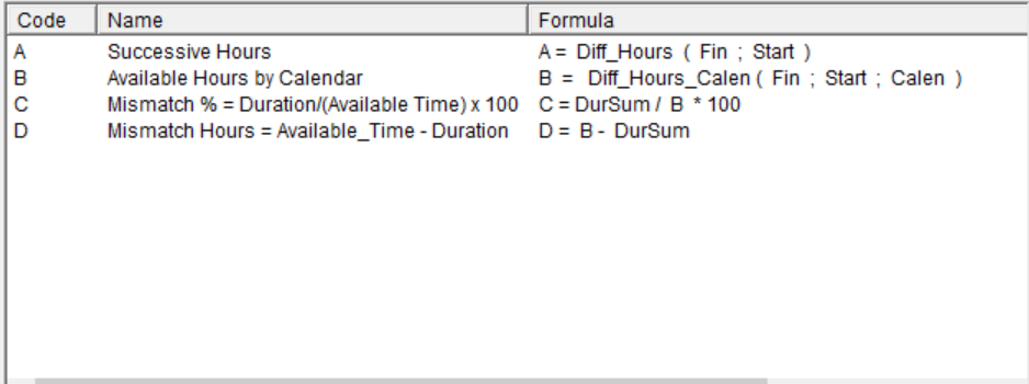

With a few simple formulas the mismatch can be quantified. Formula execution is set to execute automatically in Activity Gantt after scheduling.

In addition to activity mismatch I also want to calculate the resource mismatch; it is not necessarily the same for all resources within same activity team.

one easy way is to change all activity DPH type to Duration (for example using formula), set Start NET equal to Start (formula), delete all resources, calculate project schedule and compare two schedules.
This way you will get the mismatch for all activities.
To create the schedule based on resource calendars only change activity calendars to 24/7 without exceptions.
The same can be done with resources instead of deleting them.  This can also be done applying formula.
Another option - not applying Start NET. Then the schedule will ignore resource constraints and calendars. Comparing with this schedule can be also useful.
This exersize will take several minutes.
