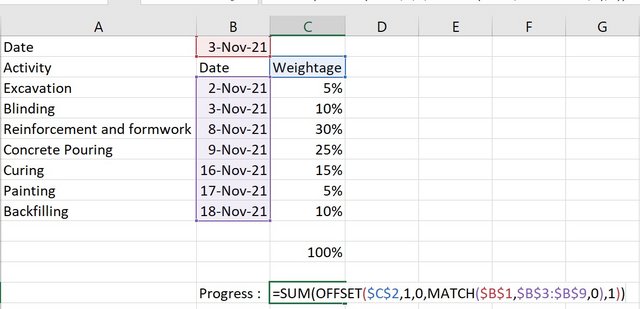

Not sure if I can post it here, if not please dont respond.
I need to calculate Overall Planned using if function or any other excel function. As and example I have plotted this below
On 3rd Nov I want to see the Planned % (A) = 15%
Date3-Nov-21
ActivityDateWeightage
Excavation2-Nov-215%
Blinding3-Nov-2110%
Reinforcement and formwork8-Nov-2130%
Concrete Pouring9-Nov-2125%
Curing16-Nov-2115%
Painting17-Nov-215%
Backfilling18-Nov-2110%
 Total      100%
 Planned %       A
Can it be done in excel, ie one cell (A) will say what was the planned % a range on 3 Nov 21.

Rodel Marasigan
User offline. Last seen 9 weeks 6 days ago. Offline
Joined: 25 Oct 2006
Posts: 1699
Hi Jithin,
Yes. Just change the match type to 1 instead of 0.
Ex: =SUM(OFFSET($C$2,1,0,MATCH($B$1,$B$3:$B$9,1),1))
Jithin Kambhikanam
User offline. Last seen 51 weeks 3 days ago. Offline
Thanks Rodel,
It does work but there is a small catch here.
If the date is not mentioned in Cell B1 doesnt match the dates in Cell B3:B9, then the result is #N/A.
Say in the above table in B1 if I put 4-Nov-21, Result = #N/A.
It should rather give 15%.
Any way to sort this out.
Jithin
Rodel Marasigan
Joined: 25 Oct 2006
Posts: 1699
Yes, you can use sum function with offset and match to get the correct range. I assumed that your lookup is the date.
Column A = Activity
Column B = Date
Column C = Weightage
Ex: =SUM(OFFSET($C$2,1,0,MATCH($B$1,$B$3:$B$9,0),1))
Sum-function
