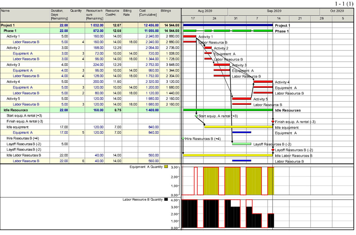

If using P6 be reminded that P6 consider an even daily distribution for resource leveling therefore your leveling might still be overallocated.
  • Reviewing Resource Leveled Schedules Using P6™
  • page 24:  4. Resource Curves. The scheduler can use P6 to define how to allocate the resource utilization over the duration of the activity. This is normally not a resource leveling issue because P6 resource leveling does not currently consider resource curves when resource leveling. P6 just uses an even daily distribution for resource leveling.
  • As far as I can recall the use of resource curves is recommended for initial summary planning with no automatic leveling.
If using Spider Project the software can automatically level for variable quantities taking into consideration how production rates might change.

man-hours
Please be reminded that billings should cover costs of idle resources and these hidden costs must be tracked and managed as not to loose money.
Cost-of-idle-resorces
