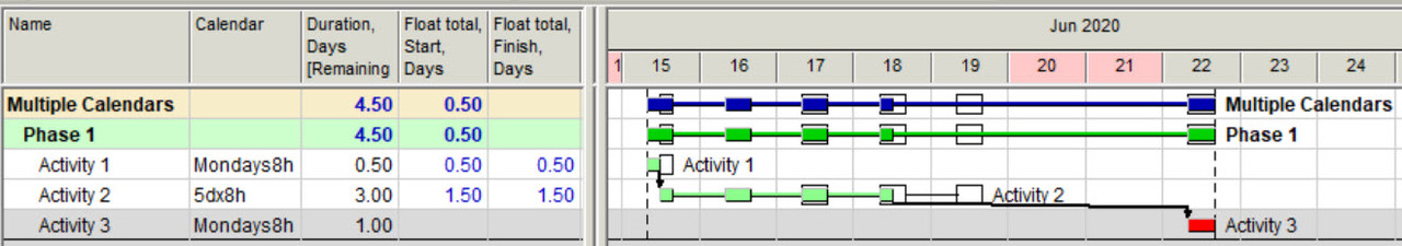

User offline. Last seen 22 weeks 5 days ago. Offline
  • This is a different section than P6 where your protest shall also be posted.
  • Please be reminded that not all software have such calendar issues.
  • Some schedulers do not understand that multiple calendars can make the critical path to be broken into several non-contiguous segments and tweak the schedule to force the critical path to be contiguous.  This is float sequestration, it is not good practice and is prohibited by most scheduling specifications.
  • Multiple-Calendars02
  • The “Longest Path” algorithm is widely believed to reliably identify the critical path for schedules with multiple calendars.  However available literature on the WEB claim P6 does not always correctly identify “Float” or the “Longest Path”.  Oracle acknowledges “P6 Longest Path” is broken when activities are no longer driven by relationships; that is, when activity dates are driven by constraints or resource leveling.
