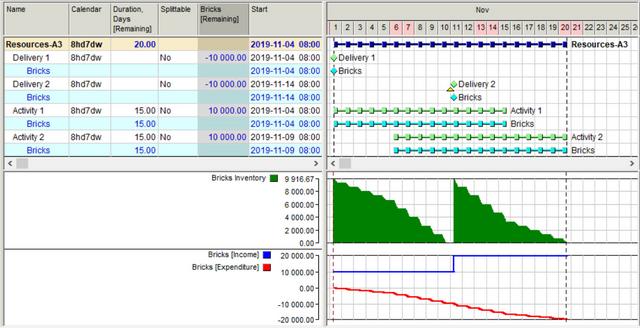

Raymund, Spider thinks as I explained and delayed an activity automatically. Now for some reason it is called AI. You always state that P6 does this but never explain how. This is what I asked you - how to make P6 to level project materials. Please explain.

7104
Raymund,
activity 2 starts 5 days later because if it will start earlier material will be expired before its finish.
Each activity consumes material as planned (uniformly 667 per day).

User offline. Last seen 12 weeks 3 days ago. Offline
My answer:
Bricks-Leveling-2019-11-02-10-33-34

Dear Raymund,
I did not find this and hope that you will explain how to do material constrained scheduling in P6 using very simple example.
Let's assume that material (bricks) is supplied twice: at the project start and then at the start of eleventh work day. Each time it is 10000 pieces. This material is used on activities 1 and 2, each has 15 work days duration and needs 10000 pieces of this material (bricks as an example).
Activities 1 and 2 consume this material uniformly, do not depend on each other, and are not interruptable.
Please explain how to set this project in P6 and automatically schedule it taking into account supply constraints.
Thank you in advance,
Vladimir

Vlad, P6 can manage whenever a men or material can be available and it can schedule the activity accordingly.
Zoltan,
I understood the requirement as the need to create and optimize project schedule basing on supply and resource constraints that are different at different times, and provide reports on resource and material flows.
Are you sure that P6 can take into account material supply constraints when calculates project schedule?

Hi Morne Iohann,
men and material flows are modeled in Spider Project software.
