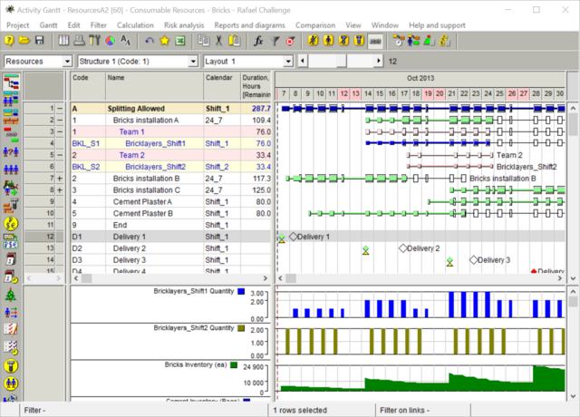

Going back to your original questions:
Do you need to reflect this night shift works in the calendar?
What difference does it make to the schedule if you change the calendar apart from changing the activity durations?
  • The resource calendar is used to determine when the resource can work, if you change it you change when the resource can work.
There are several other serious issues though.

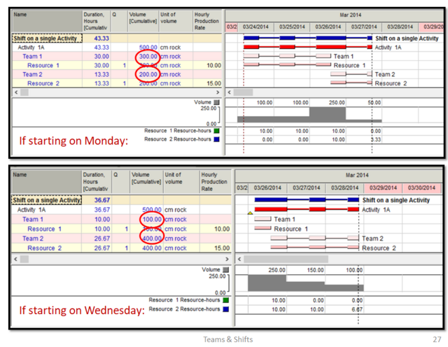

Primavera P6 cannot adequately model resource production rates [if at all] and therefore activity duration will be modeled as if different production rates among the different shifts do not matter. Try to model the scenarios under my post of Thu, 2018-11-01 16:10 if using P6 and see it by yourself.
Resource leveling when shifts are used is tricky, error prone and in some cases errors unavoidable as shown in the following reference.
Under certain circumstances shift resources will not be adequately leveled.
There might be issues with partial workloads when using a single shift, when using multiple shifts the same problems can be expected.
  • In my posting of Mon, 2018-11-05 09:23 slide no 6, such issues are illustrated using a sample scenario if using Microsoft Project.
  • Because renewable resources are assigned as unit of effort but not quantity it is possible P6 will yield results similar to Microsoft Project.  Currently I have no access to P6, I had it years ago, I have not been able to discard it does not happen if using P6.  For the moment this question I see to remain open.

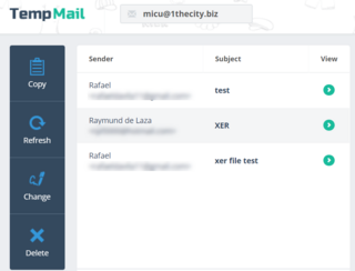

Raymund,
Your e-mail was received but the e-mail server but did not allow me to open it nor download it. It is weird as I tried some test files for the temporary e-mail address and all worked fine; one test e-mail included a xer file as attachment so I am ruling out xer files are rejected by the system. An error message displays whenever I try to open your e-mail. I opted to close the temporary e-mail address, if need be a new temporary e-mail address can be created anytime.
Temp-Mail
We will have to figure out other way, as we say at home “where there is a will, there is a way”.
I will try to contact TempMail to see if we can figure out what the error message means and will let you know.
Once again, thank you.

Workload-Scenario
If you assign resource A1 to work 4.8 hours on one activity it is 60% workload but if you assign same resource to work his remaining 3.2 hours on another 8 hours activity this makes 40% workload, the requirement is to assign same resource 60% of his work time, not a combination of resources as it seems P6 is doing on the background.  This is captured by most software if using named resources, most fail miserably if using generic resources. That P6 cannot properly level partial workloads can easily be shown with this sample scenario; if using named resources, no matter if using generic or named resources to same scenario the result must be the same.
Generic resources are commonly used instead of named resources because at time of scheduling you do not know the mane of each resource as well as because it is practical it should not matter if a specific resorce name is Pete or Alberto, it still makes one single resource.
What is the result if you use generic resources using P6?
What is the result if you use named resources using P6?
If P6 gets it wrong if using generic resources, P6 gets it wrong at the most frequently used methodology to assign resources.

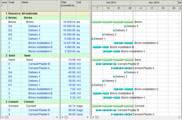

Installation of Materials are consumable resources that represent volume of work, if used on same activity they represent different volumes of work on same activity. Same as regular renewable resources they must be leveled, if not available activity execution stops. Because their installation is a function of brick installation it is enough to model Bricks volume of work for activity, you shall be able to view materials installation/consumption within a view or a report. Now we are talking about models a tad less easy. A detailed discussion of this belongs to different topic.
In this scenario materials are to be delivered once a week by barge to a remote island.
Materials01
Materials02

Anoon,
on the screen below one activity that is done in three shifts.
On the 1st day only shift 1 is available, on the day 2 shifts 1 and 2 are available, on the day 3 all shifts are available.
Activity has 100 units volume. Productivity of the first shift is 1 unit per hour, second shift has 0.9 units/hour and 3rd shift 0.8 units/hour productivity. They work until the whole activity volume will be done.
Let's assume that they spend some material with the name of concrete 1 unit per volume unit.
Diagrams below Gantt Chart show material consumption per hour and cumulative.

Anoon,
Same as Vladimir I cannot follow your request but It is enough to show the one activity sample schedule I already provided. It is a no brainer, if activity start moves so do shifts start, because shifts have different production rates the activity duration changes. If you split the model into two activities in no way the model will make the adjustments as it will not know what volume of work is to be performed by each individual activity. If the volume of work is kept within a single activity the volume of work remains 500cm. Please turn on the volume, the music is on the house, expand to full screen for a better view.
Please take a look at my Fri, 2018-11-02 18:43 post for a static view.
If activity starts on Monday:
Monday =>> Resource 1 will produce 100 cm
Tuesday =>> Resource 1 will produce 100 cm
Wednesday =>> Resource 1 will produce 100 cm
Wednesday =>> Resource 2 will produce 150 cm
Thursday =>> Resource 2 will produce 50 cm in about 3 hours
Activity will take 3 days 3 hours.
If activity starts on Wednesday :
Thursday =>> Resource 2 will produce 150 cm
Friday =>> Resource 2 will produce 100 cm in 6.67 hours
Activity will take 2 days 6.67 hours.

User offline. Last seen 9 weeks 42 min ago. Offline
Breaking up activities does not make sense when different teams work on the same activity.  Splitting the activity is a very poor work around when different shifts work on same activity.
When you split a resource loaded activity because other activities might be competing for the same resouces there is a risk each sub-activity will be scheduled non-contiguous by the resource leveling engine.  If not enough re-distributing the volume of work among the sub-activities and calculating their adjusted durations every time these are delayed as schedule moves will be a nightmare.
Learn to schedule shifts within same activity using your software, no big deal, should be easy.
teams-and-shifts
