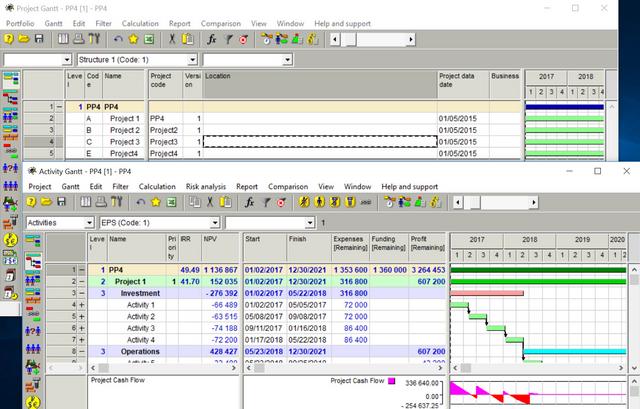

I use Spider Project, when in a Portfolio Database we can see the activities at the Activity Gantt, here we can create the interproject dependencies, here we can also assign shared resources, here we can run resource leveling on Monte Carlo for a portfolio of jobs, and so on.
investment-portfolio
