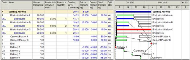

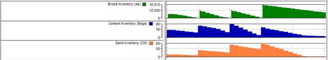

To figure it out we can try resource leveling the following consumable resource scenario [Bricks/Cement&Sand] that is unfeasible unless all are leveled or constrained.
Materials-prior-to-leveling
Materials-prior-to-leveling-02

As Vladimir said before – “Manpower shall be leveled but it does not mean that the best solution minimizes idle time of all trades. Fast execution of the critical activities minimizes project duration and indirect costs. Additional indirect costs may be higher than the cost of resource idle time. Resource optimization has constraints like certain target dates and criterion (usually overall project cost). So an approach that minimizes resource idle time does not always lead to the best solution”.
Say delivery 2 is delayed 3 days then what is best action to prevent delays?
Under such delivery schedule better allow for more than 2 bricklayers [16h/day], if availability is increased to 4 this will allow for more than 2 activities to be scheduled at the same time.

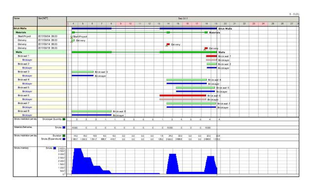

Resources-A1-2-3-Brick-Walls
https://www.mediafire.com/file/5yj45a11jsygvhs/Activity_Gantt_-_ResourcesA1.2_%5B3%5D_-_Brick_Walls.pdf/file

Johanness solution is overloaded, easy to verify if calculating materials/day and keep cumulative values to calculate inventory levels - please click following link for a PDF you can download.
Or take a look at the following worksheet.

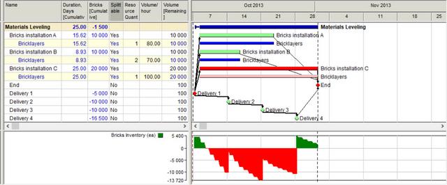

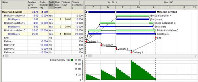

ORIGINAL CHALLENGE - It is just 3 Brick installation activities, 2 cement plaster activities, 4 delivery activities, 3 consumable resources (bricks, cement & sand) and 1 renewable resource (bricklayers) with an availability of 3 assigned in different quantity to the installation activities.
SOLUTION:
Materials-after-leveling
Materials-after-leveling-02

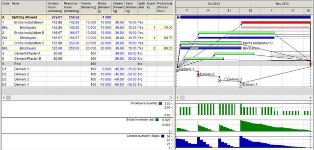

I have adhered to all the constraints in this challenge and designed a scheduling model that will work and I ask you to look again at the images I have provided and you will find the answer. Do you concur that mine is better leveled of do you have any other opinion? You can see the histogram for the 3 bricklayers.
No manual leveling, no constraint One click of the mouse, after the designing of the model.
For illustration see the next images.
Materials_Leveling_with_a_2nd_Shiftrev
Overall_Picture_with_comments
Regards Johannes

Johannes,
Yes, I have uploaded a large image and hope that this is better readable.
  • I downloaded it and is still unreadable. The missing information is still missing.
  • Instead of using “print-screen” I get better images by printing a report into PDF, then using my PDF editing software I export the PDF to jpeg, finally I crop the jpeg and post the image.  For Powerpoint png yields better results.
  • Please post the XER file of the model you already have.  It does not make much sense not to use XER files.
  • That would make everithing easier and will solve most of the basic issues.
But I also conclude that at the same time the manpower histogram for the bricklayers is not adequately leveled.
  • Please be specific, we can verify hour by hour the histogram.
  • We level resources not effort; this could yield unfeasible leveling if using partial workloads.
I consider that the labor resources should be leveled or smoothed taken into account the constraints on the material delivery and go for the best-suited option.
My model, as you can see, is designed to have a permanent un interrupted work process for the bricklayers, with a minimum of “lost time.”

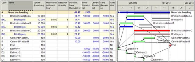

Raphael, I have studied the outcome of your leveling efforts, and I have the following comments.
I conclude that you show nice run-down curves for the consumption of the consumable resources. But I also conclude that at the same time the manpower histogram for the bricklayers is not adequately leveled. I consider that the labor resources should be leveled or smoothed taken into account the constraints on the material delivery and go for the best-suited option.
Johannes

Please be reminded your images are unreadable.
A lot of information is missing as I can only see many summary bars but not the activities.
  • I cannot see the activity start and finish dates of the activities so I can test the schedule using simple start not earlier than constraints and force the model to use your dates and verify how the inventories move with time if using my software.
  • Are you using milestones to assist you in manual leveling and using the software to make the checks in the same way I would verify your schedule? It looks like date constraints are driving the leveling.
  • The model is not using activity splitting as required.  It is not a good idea to keep uninstalled bricks when they can be installed earlier. Intermittent installation of bricks is desirable even if it ends up with same project duration.
  • I cannot see late bars.
  • I cannot see resource quantities.
  • Can you post the XER file?  I do not have P6 but I can read it.
I saved your image but it is blurred, I could interpret a finish date for installation activities of 19-nov-13 12:00.
Can you please post some downloadable images that are not so blurred?  You can click on my image and save it; if you zoom the image it will still be readable.
I cannot understand why you created a separate activity for every delivery item, in real life each delivery can consist of many items, each delivery with different items and quantities. It is not a pragmatic approach.

Here is my leveling overall picture  for the example Raphael suggested

My response now.
Apparently, you have made a choice, see above,  that the bricks delivery should fit the output from the Bricklayers 16 hours/day, and this would put the completion date at 20 Sep. 2017 and not as Oct. 04-2017 for the bricks. I have not made this choice because. It is obvious that this could not be correct because of the rate of supply of 700 bricks a day, as you are have demonstrated.
If I would make the choice that the leveling priority for the bricklayers has priority above the supply of materials and that these are to be speeded up to match the output of the bricklayers so that they can, without interruption, complete the work at Sep-04-.
So I have modeled the schedule to reflect this situation, and you see the outcome hereunder.
Histogram_leveled_for_Bricklayers
Activity_resource_assingment
Histogram_for_Bricks_leveledl
Regards Johannes

The following resource leveled schedule can showcase different production rates and what happens when planning for all installation activities allows splitting.
Not leveled schedule showing materials overload.
BL001
Leveled schedule allowing for activity splitting.
BL002
Leveled schedule not allowing for activity splitting yields a longer duration schedule.
BL003

User offline. Last seen 20 weeks 2 days ago. Offline
Johannes,
P6 calculations are unreliable but I believe in this case there is more than P6 unreliability.  A simple report that details on a daily basis how bricks are consumed and produced is enough to show if it is wrong.
As soon as brick inventory/cummulative/running values go into the negative there are no bricks to install !
Next figure displays how daily inventory is accrued per activity using standard software report.

Hi all
I have updated and edited the original post and added screenshots.
Please scroll down.
After making sure the start of project matches this is what I got it is not a good solution, is unfeasible. Easy to verify if fixing dates using start no earlier than constraints and look for overloads.
SORRY THE IMAGES GOT LOST - Until provided with readable images by Johannes I cannot create them again.
I tried Johannes example but got different results. If to use activity priorities defined by their order:
Bricks_with_priorities
If to ignore activity priorities:
Bricks

Vladimir,
The first image provided is the unleveled schedule and the second one the leveled schedule by Johanes.  Should be easy to create the model in Spider if readable and all required information is there.
