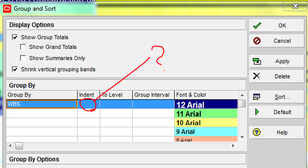

Hi, after I merged 2 schedules by importing XER, the WBS indent gone missing (see pic 1)
2341
and I have noticed "???" on the group and sort drop down list as below
2340
also, the WBS seem double at some area
2342
anyone has the same problem before and please advice if know any solution, many thanks.

Lee Kee Ting
User offline. Last seen 10 years 34 weeks ago. Offline
Joined: 4 Mar 2010
Posts: 4
Thanks Raymund, its work! many thanks.
User offline. Last seen 35 weeks 12 hours ago. Offline
Posts: 762
Lee, Remove the UDF named WBS.
