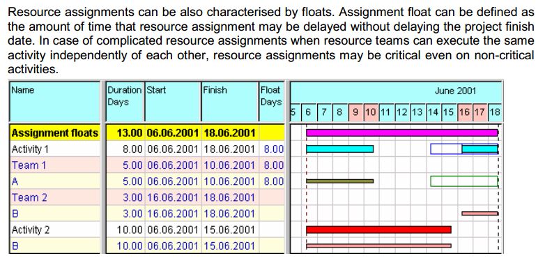

Do not forget calendars are assigned to activities as well as resources; they need not be equal but compatible/consistent.  In case of complex resource assignments you might also need to pay attention to assignment floats.
Resource Critical Path
Image-036
Multiple calendars make summary floats meaningless, keep the focus on the activities and resource assignments no matter your software.
