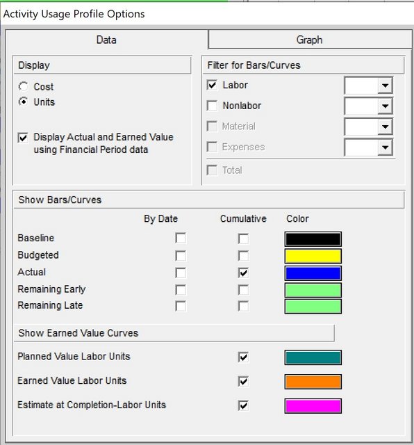

Hi Erik,
Actualised version means. It has actuals, updated and not fresh baseline with no progress at all.
Please note: If you are using the Financial Period you cannot used the BL Project Labor for comparison. You must use the Plan Value Labor Unit, Actual Labor Units, Earned Value Labor Units and Estimate At completion Labor Unit only. Plan Value Labor Unit is based on Project Baseline if assigned and selected.
Activity-usage-Profile-EV2

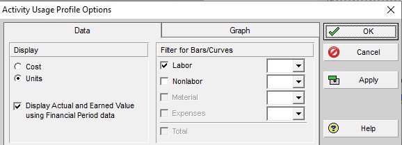

Yes, both those settings are like your screenshots:
