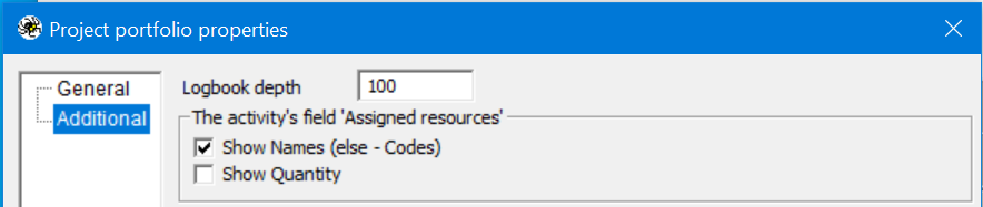

In Spider Project we have an audit table called Logbook.  You can set up the maximum number of entries to be up to 10,000; it should be good enough to make any corrections in time.  If after 10,000 entries you might still need to look at previos entries then you sholud periodically backup the table as a separate document for future view, say backup the table once a week.  Auditing schedule entries for corrections after a week can be too late.
