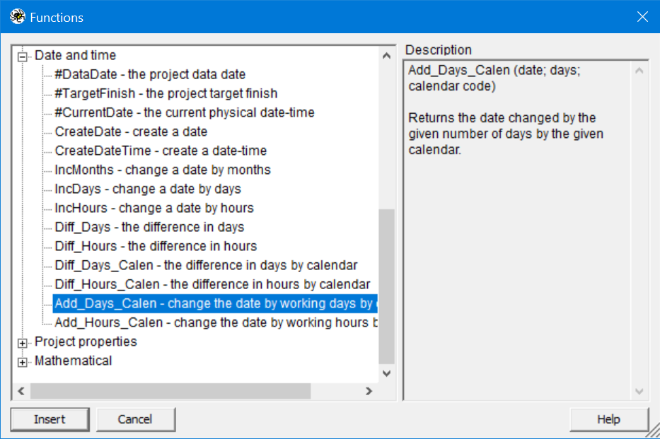

Can be done in Spider, I was hoping P6 could. In the following portfolio each job have multiple calendars of their own as well as the portfolio. In this way non-work days such as Sept 24 will be considered as such in the calculation. CurTime is the field code for Project Data Date, not necesarily a code of my liking, but field name "Project data date" is.  Creating a filter at the Activities View is a bit cumbersome so I would just sort Project Data Date and use earlier date for my filter start date, then sort field A and use latest date as my lookahead filter end date.

Any job can have many calendars some global other project specific, so you have to tell the filter which, otherwise it would use consecutive days.
I do not believe P6 has a function to change the date by working day by calendar as Spider does.
calendar-functions
