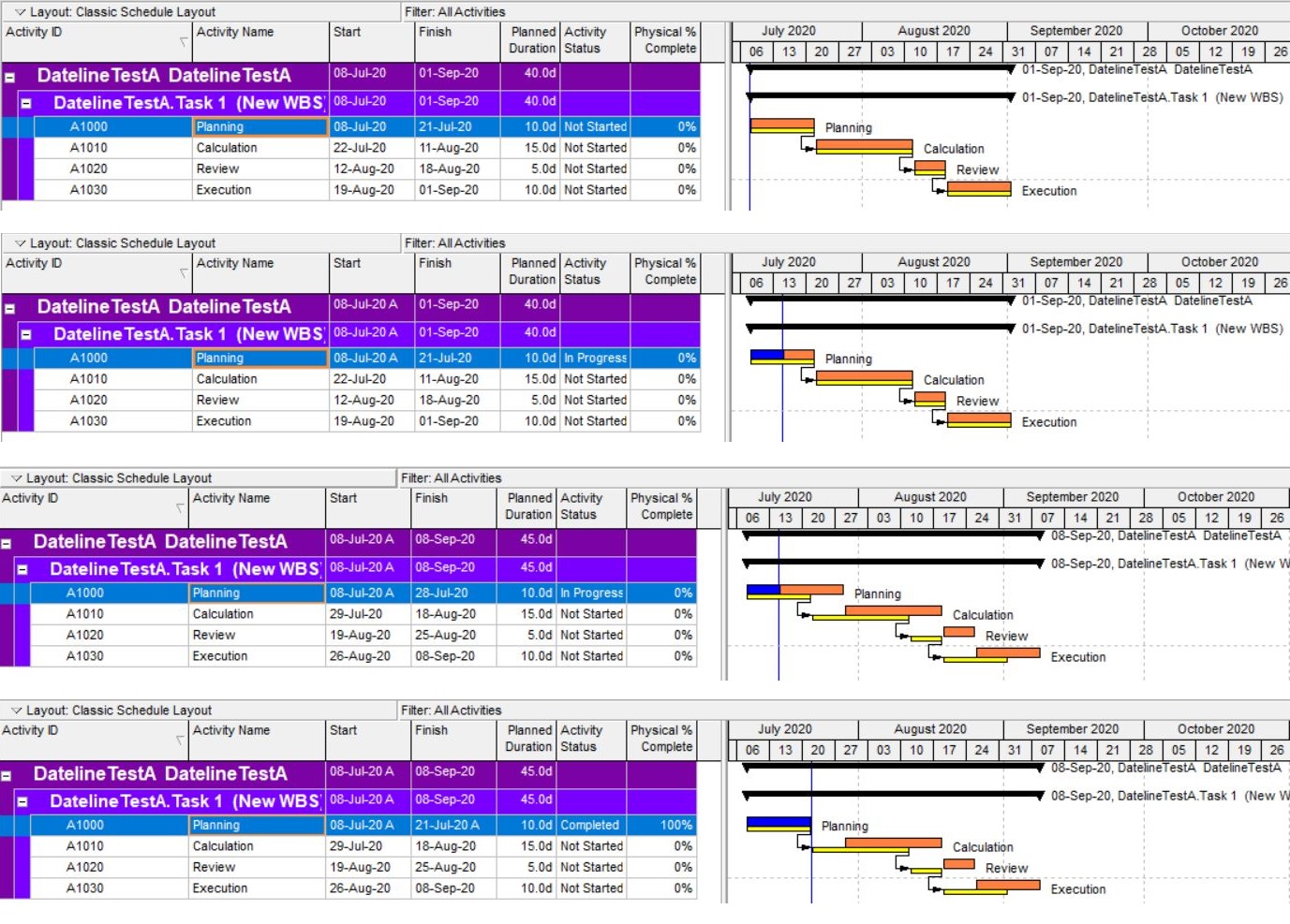

it is doing this because you used "Update Progress"
Iin snap shot #4 the software put a 1 week lag in between the data date and the START of A1010 because you said it was "ON SCHEDULE" forcing the sofware to do what you asked it to.
if you update it the way that I mentioned you would see activity A1010 would start EARLIER than the planned date and would start on data date or July 22, 2020 because its predcessor A1000 was completed on July 21, 2020

Thank you. I get that, but due to the successor relationships, if you change the remaining duration of one activity it can slide lots of other activities out of whack causing a lot of confusion. Well before F9/Schedule button has been used. See my images in the last post - they are both before the Schedule button is clicked.
Thank you for your replies. I have created a new test project to learn how to update a schedule using the recommended methods. I understand how checking started/finished and updating the duration then hitting “Schedule” puts the activity in the correct place with accurate values. What I am worried about is the likelihood of errors occurring due to confusion during the update process.
Example below (I’m ignoring the baseline feature for now, until I get my head around this first), schedule needs updating one week, weds-weds – once updated it should show activity A1040 as “in progress”, all other activities will remain unchanged (image 1).
However, edit activity A1000 “Remaining Duration” to 3 days (image 2) and the entire schedule is thrown, displaying A1040 to be marked as completed and activities A1010 & A1060 to be marked as “in progress”. I realise once I hit “Schedule” it should reorganise everything back to the where it should be, however in reality there could be many activities with a direct predecessor relationship to A1000 and many more secondary relationships after that, they could also be separated by 100 or so activities between them. Unless I have absolute knowledge of all the predecessor and successor relationships and know when the original dates were, what is stopping me from incorrectly marking activities as started or complete?

Thomas is correct thast not
Thomas is correct thast not how you properly update a schedule just step through that activites that have progressed and recalculate your schedule is a simple process.
By using UPDATE PROGRESS you ARE indeed saying that everything has gone to plan. DO NOT USE IT.
Furthermore this does not forecast for you. i.e something was to take 10 days now it takes 15 days that is not taken into consideration it need input from intellegent people who know the work that is going on.
