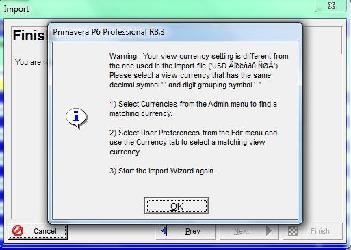

I need to import an XER file, however, the file relates to a Russian Project and I am getting the following error message when importing:
2339
Obviously, when I try to find the correlating currency setting it is not present. I assume that the issue relates to the Russian alphabet being used in the file.
Any advice as to how I can resolve this situation would be greatly appreciated.

Thanks Raymund.
I got a bit distracted by the language barriers, was a simple "fix", I'd forgotten to alter the decimal symbol. The Russian characters had nothing to do with it. That's what happens when you work on a Sunday evening...

Steven,
In your P6 set your language to Russian prior to import.
