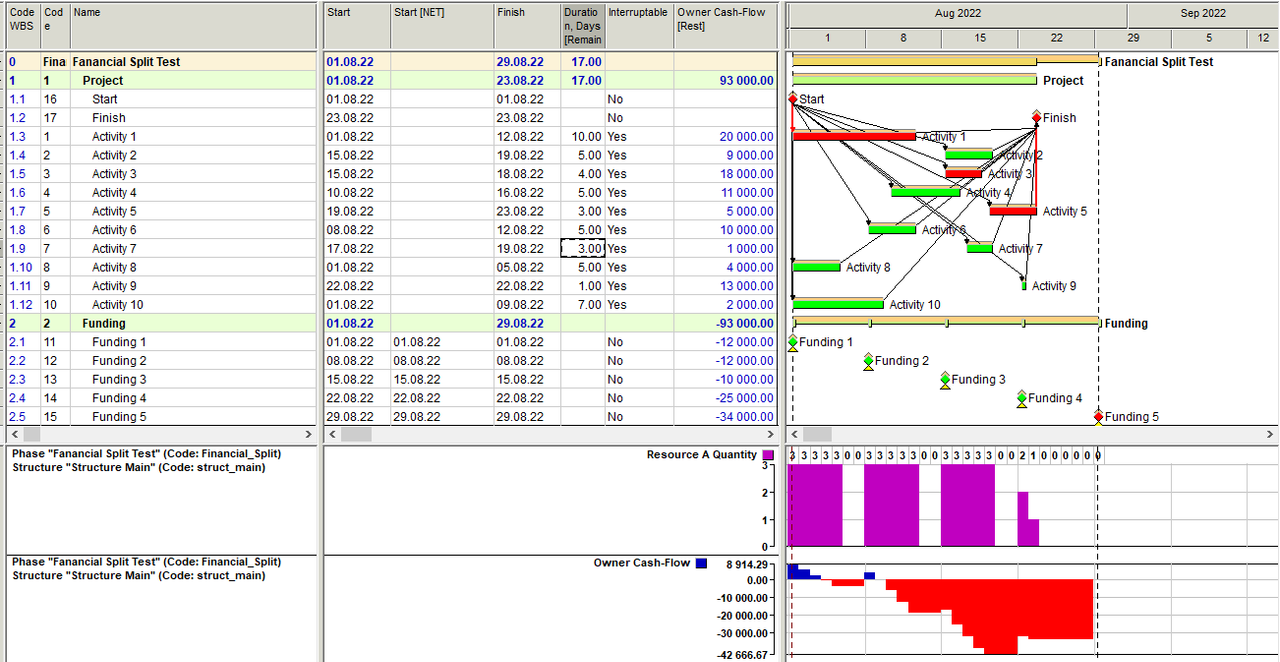

I do not want to compare Resource Constrained Schedule with Financial Contrained Schedule. I want to find out how much will financial constraints will delay the Resource Schedule. I do not want to split activities during Resource Constrained Schedule because this is not how I will do the work.
I followed your advise with a few minor changes. Here is what I did:
01. Resource Constrained Schedule - without Interruptions
01-Resource-Level-No-Interruptions
02. Made Resource links to real link (cancel Resource Link Flag)
03. Financial Constrained Schedule (only) - with Interruptions
02-Financial-Level-With-Interruptions
04. Resource Constrained Schedule - without Interruptions, but From the first day when I have resource Overallocation. This is my final schedule since I have the Minimum Duration for Resource Leveling and Minimum Duration for Financial Leveling.
03-Resource-Level-after-Financial-Level-No-Interruption
free image upload service
The problem is that in this particular case the Financial Constraint was on the last Milestone. If if was on the second milestone I would have had to repeat steps 02-04 for the next 3 milesones. A time consuming iterrative process.
Another problem is that  in large schedules the user cannot easily determine if the activity is Interupted because of Resource leveling or Financial Leveling or Material Leveling.
From this problem came the ideea to create option for Interruptions: Resource, Material, Financial. Basically adding this option would restrict the Interruption of activities only for a certain type of leveling and the user cand run all 3 levelings at the same time.

Bogdan,
I don't understand your idea and what do you want to achieve.
Resource constrained schedule will delay activities due to resource constraints.
Financial constrained schedule will remove these delays and will create other delays.
What information will you obtain comparing these schedules?
If in the resource constrained schedule the funding is not sufficient it makes sense to check what delays will be created by limited funding.
I suggest to try this:
1) Calculate resource constrained schedule (without interruptions) creating resource dependencies and save it.
2) Make resource dependencies real.
3) Calculate cost constrained schedule (with interruptions if you want).
4) Compare these schedules to see what delays were caused by limited funding only.

User offline. Last seen 20 weeks 2 days ago. Offline
Consider showing FLEX
2022-07-06-11-17-39-Resource-constrained-scheduling-options
no splits but Flex will provide the information in a single view as follows
2022-07-06-13-10-28-Activity-Gantt-Financial-Constraints-100-Financial-Constraints
adjust schedule using available activity flex: you can split the activities if want to start earlier those activities with start flex
2022-07-06-13-04-21-Activity-Gantt-Financial-Constraints-200-Financial-Constraints
