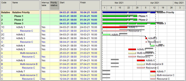

Hello Vladimir,
For some time I have seen you added a new field called Priority Relative.
From what I have read in the manual Spider considers priorities as follows:
a). Phase priority is the highest priority and if a phase has a priority then the activitiy priorities in the phase will be ignored;
b). Activity priority will be respected in the Standard and Advance scheduling but it may be ignored in the Optimization and Optimization+ algorithms (if the resulting schedule is shorter).
Also from the manual (Russian manual) Priority Relative is am absolute priority that will be respected using any algorithm (from what I could understand). Here are my questions:

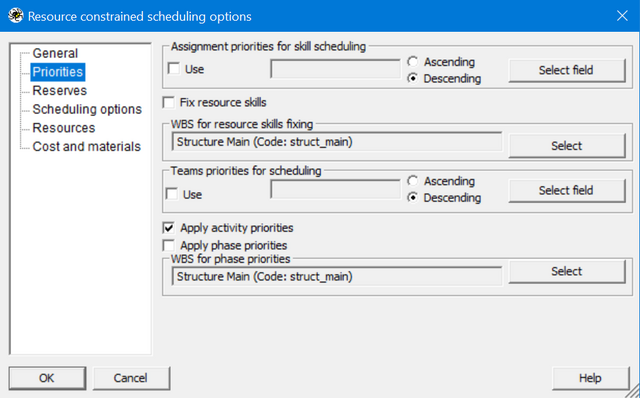

01. Is Priority Relative an absolute priority, no matter the algorithm?
02. Also how does Relative Priority behave if you compare it to Priority (see points 01. and 02.)?
03. Does the user have to check the Apply activity priorities and/or Phase priorities?
04. What happens if there is a conflict between Priority and Priority Relative?
05. How does Relative Priority enforce strick links? (Sometimes algorithms may break strict links - even Standard. Not very desirable; I understand that Spider searches for the shortes schedule, but there are scenarios when the strict link should be always enforced since it represents a technological dependecy; but this is another topic.)
Could you please explain in more detail how Priority Relative is different from Priority?

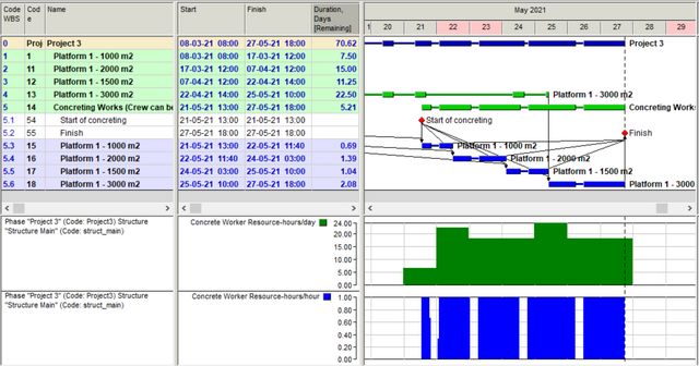

Bogdan,
in my scenario concreting started before PVC Foil was finished on all platforms.
Start of concreting prefers starts of concreting on all platforms and is ALAP activity. It does not have predecessors.
Second solution is more elegant but testing it I met the problem that we will solve in the near future.
You can create WBS where all dummy activities will be excluded.
You assigned priorities to platform concreting. I did not do this. Priorities do not change overall duration.
there was a condition: to do concreting without interruptions because concreting crew is invited.

Look at https://www.mediafire.com/file/g0v6x7s0ut84osj/Platforms.004.sprj/file
I created dummy material called Location restriction.
One unit of this material is produced at concreting Start, then it is consumed at the start of work on each platform. At the end of work on each platform this material is produced and so the work on another platform can start.
Project was leveled taking into account material "Location restriction" constraints.
I noticed wrong values of resource constrained floats on one of platforms. We will study this problem.

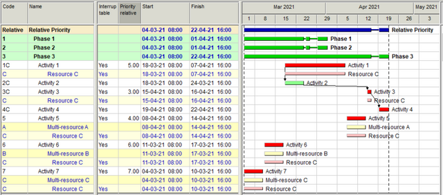

from what I was able to understand regardin Priority Relative it doesn't matter if you assign the value 1 or 100 because eather values will force a split in an interruptable activity. If you assign different values for the Priority Relative field these will be taken into consideration only for those activities with Priority Relative.
Vladimir, please correct me if I am wrong.

Rafael, let's consider the simple scenario:
You have certain time windows for work at the certain place. Otherwise the same resources will be used different ways.
It is necessary to move resources to different work at certain times.
Relative priorities is the simple way to model this case.
Relative priorities are used rarely in cases when there is a need to assign highest priority to certain activities without changing the way the project is scheduled.

Image-003
Image-004

Image-001
Image-002

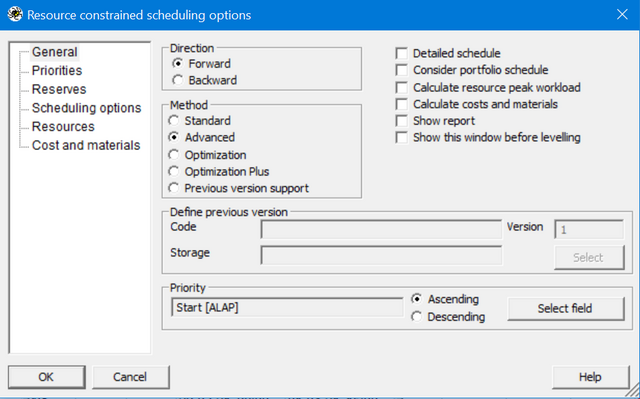

Would it make sense to create an option to assign relative priorites similar to activity priorites under Resource leveling options?
I do not understand, Priority Relative is taken into consideration only when using Resource leveling. Do you mean something like "Disable Priority Relative" similar to the option "Disable interruptions"?
And what about a warning box when it makes sense to use relative priorities? A warning that can be toggled on/off.
How would Spider know when to use relative priorities?
From my point of view this option allows the user to better control the outcome of the Resource leveling and to be able to fine tune the leveled schedule.

Daniel,
everything works as intended. The pictures depict a very simple schedule model. I think that Priority Relative has many applications but it helped me solve this type of problem. It helps me model a scenario in which the main activity (Road) is interruped in order to allow other activities to be scheduled, thus, representing real life scenarios. In road&bridge works you will built the bridge when you get to it not after the road works, not before. If Priority Relative did not exist I would have had to split the road activity in many more activities in order to simulate this interruption (splitting is the correct way to do it); but if you built a schedule for tenders (for example) or just want to run a fast simulation or if you have a project with 40 roads then it can be reasonable enough to create a very simple model to simulate different scenarios (since it calcultes faster and is easyer to track).
In my model Priority defines the order of the roads, and Priority Relative just tell the Road task to split when the bridge activity has to start.

Hi Bogdan,
It seems that on figure 2 the priority relative doesn't work no, because all set "1"? The type of priority this figure is phase priority?

Vladimir,
Thank you for the sample file. Now all is clear. This functionality helps me solve an issue I had with a modeling problem I call Road-Bridge-Bridge-.... Please see below the image/link a very basic model
7660
 https://ibb.co/VqgpyRY
Basically without the Priority relative for this scenario I would have to create a link between another activity (not Road) and setup lags, sometimes it would be a dummy milestone. This was a difficult workaround.
With Priority Relative the model becomes much simpler!
https://ibb.co/FVx7kd7
7661
Thank you for the explanations, they really help!
