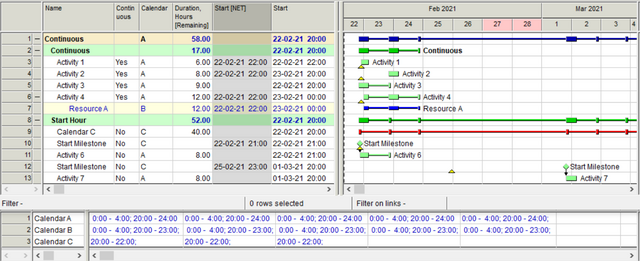

Hi dear friends,
I don't know why start date don't beginning on the start next day, this is a proposal of the function continuous no? Have some thing that I forget? Follow the link of the file... https://we.tl/t-cp7C8ev9io

Daniel,
you have lunch break in your calendar.
An activity cannot start and finish before the lunch break and so it starts after lunch.
It did not help because its duration is larger than the work time after lunch.
If your start milestone starts at the start of the work day, or at any time after lunch your will get the expected schedule.

Hi Rafael,
Thanks for your answer. This schedule is a fragnet of a bigger schedule, I adjusted calendar B, changed for C, and happens same thing.
follow file... https://we.tl/t-RJWbbnyvcI

User offline. Last seen 19 weeks 6 days ago. Offline
I downloaded the file and calendar B is used on some lags that are filtered but could not see this calendar on the calendars view, maybe the file is corrupted.
I created a simple file and it works as expected, as always.

Follow he print screen of the doubt.
