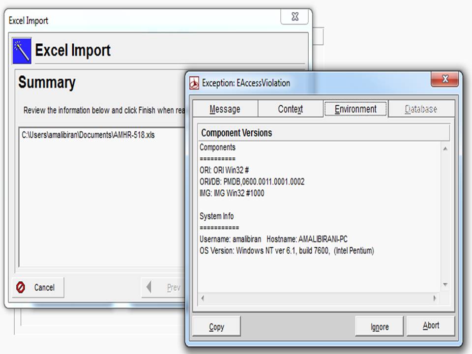

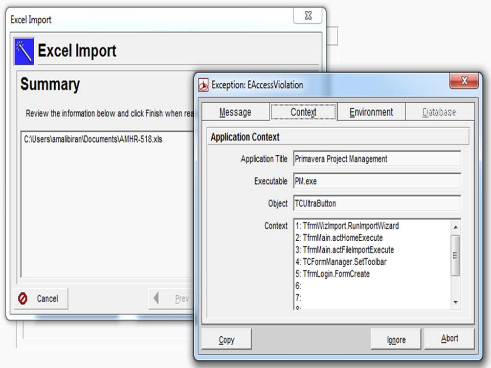

Guys, can anyone help me solve my problem in importing relationships in P6...this error always come out whenever I import excel spreadsheet relationships to P6, thus importing is not made.
Thanks,
Ariel
518
Error1
516
Error2
517
Error3

Hi Marcus!
1. Excel file is close.
2. I'm using a desktop computer. Dont know how to run integrity check;
3. 141kb only...around 1173 rows and 8 columns in use..
I tried to import it by parts but still doesnt work. by chance it works sometimes when i import few. this problem occurs only in that particular schedule. others are okey.
cheers!
ariel
Marcus Brown
User offline. Last seen 14 years 2 weeks ago. Offline
Joined: 7 Jun 2011
Posts: 4
Unfortunently the data was provided is not sufficent to determine what the problem is. Primavera's errors codes are an endless maze of possibilities. Couple of things to check. This is a memory issues so it is telling you that during the import your memoery or the servers memory is working really hard.
1.)Is the excel file closed while you are trying to import the file?
2.)Is your database structuraly sound? Try running database integrity checker to see if you have any issues.
3.) How big is your import file. Primavera has a hard time handling files over 25k+ rows and as file get wide with columns.
